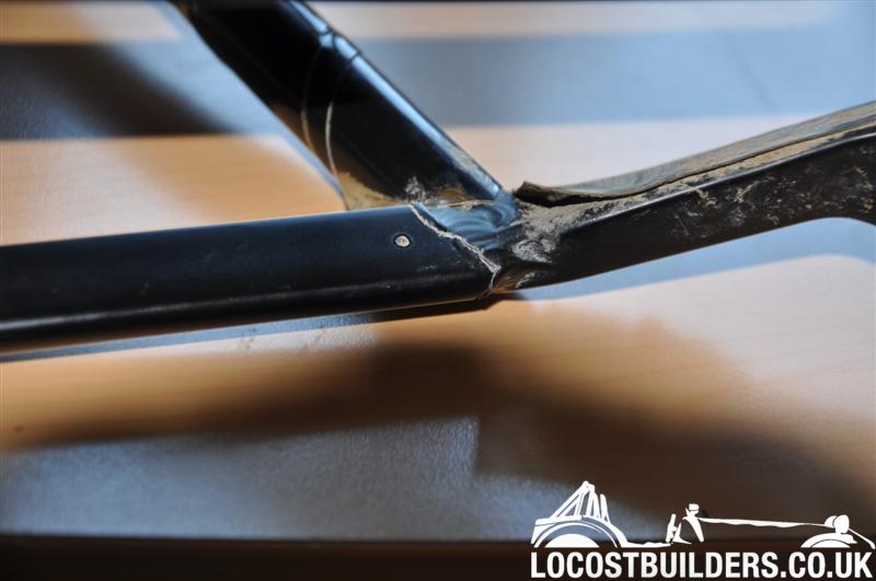

At the end of last year i bought a Iron horse MKIII Elite mountain bike, all was well for 9 months until i started having problems with the rear tyre
hitting the inside of the trailing arm under torque.. this was traced to a crack in the trailing arm upright on the right hand side..

Is it ali or steel?
Which member is breaking?
bloomin bike
red line both times... ally

you mean half way up the uproght in the rear triangle?
broken frame
that is weird place to go - I can only guess that the tube is far too thin.
to fix that, install a thicker tube or sleeve the old one, easier said than done.
alternatively some fillets down either side.

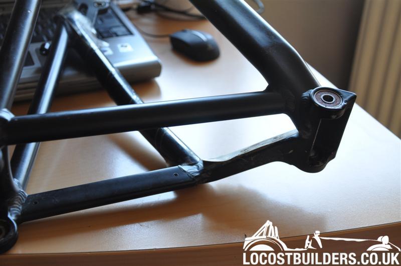

nice bike...cracking in fact ....sorry!
blimey - the whole thing looks beefed up.
Looks a very light-weight structure for the sort of use these bikes are expected to cope with, as is the whole frame. On the other hand it should be a straightforward job for a decent fabricator to fix and beef up.

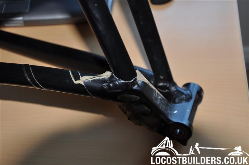

well i have the second of the broken frames back, this one broke in a different place.
I am looking at making a plate of ally 3mm thick high quality stuff and getting it welded to the front leading edge of the triangle as it sits on the
bike.
what do you guys think and can anyone here help, or suggest anywhere to get it done?
