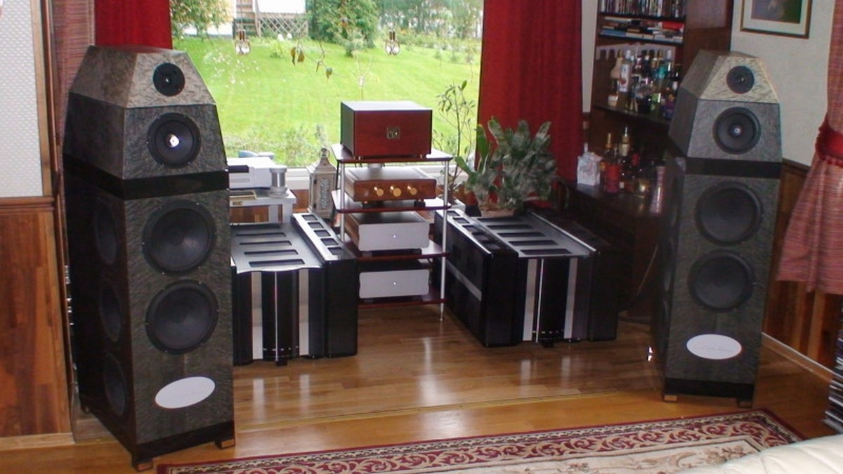

as for what im making. X2 100w solid state class A push pull balanced mono block amps and matched pre amp unit. if you know your stuff when it comes to audio you know 100watts of class A will need to dissipate a mega amount of heat and my plan is to do it passively so there is no background noise from fans etc. the electronic components and transformers i need are costing me the best part of a third world countries national debt so if i can make a small saving somewhere i can at least feel a little bit better about what i am spending :-)
02GF74 - 29/12/12 at 09:10 PM
a DIY Krell then .... going by the size of heatsinks they use, you are going to need something pretty substantial.
ashg - 29/12/12 at 10:28 PM
I hope to eat krells for breakfast but yes along those lines
ashg - 29/12/12 at 10:35 PM
pass are more my cuppa tea if i had the wonga to pick between the two.
