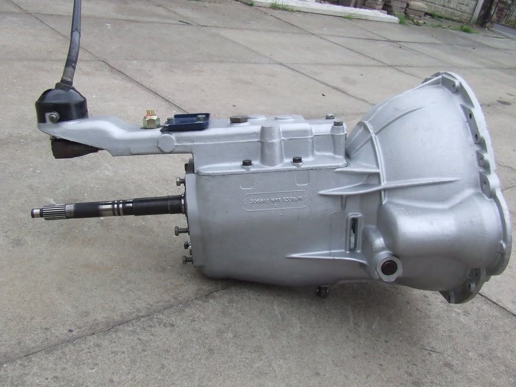

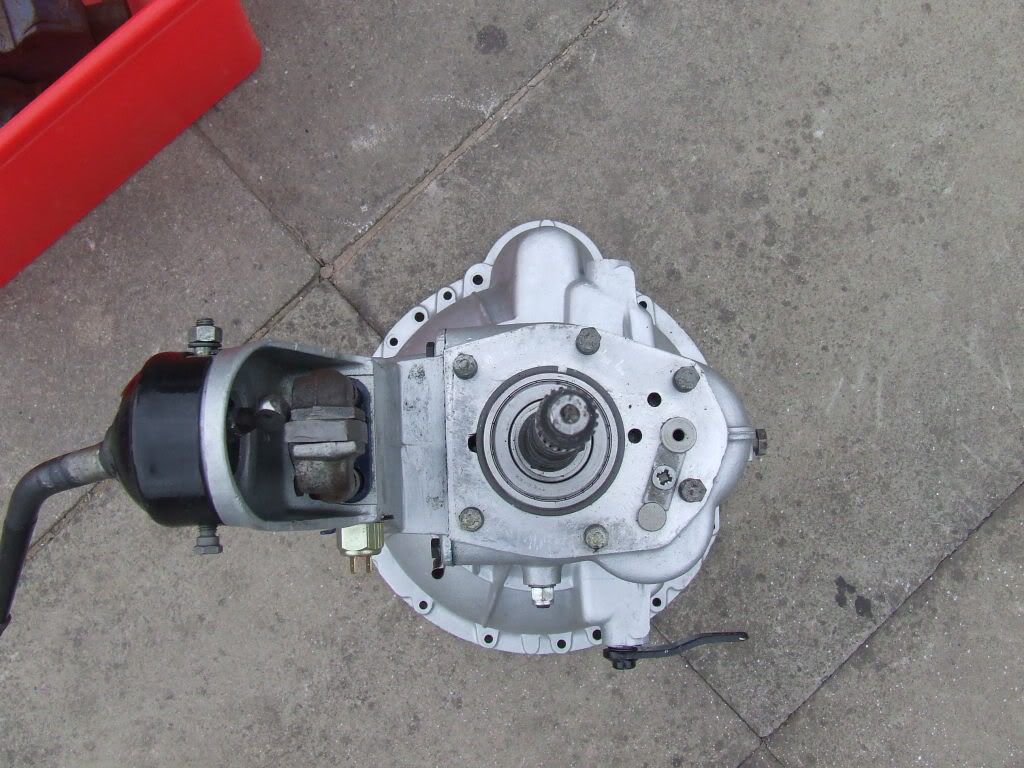

I have bought a gearbox and a box of very new looking parts that are supposed to be from a TR6

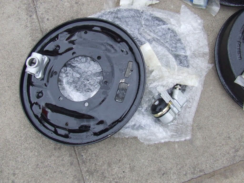

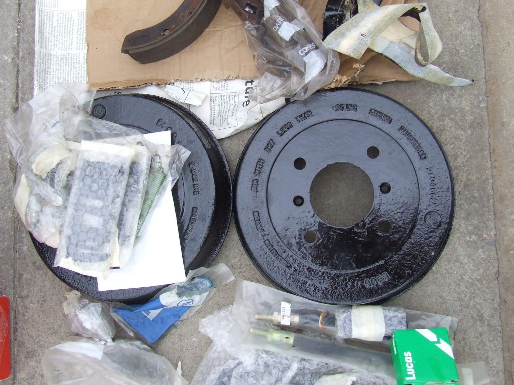

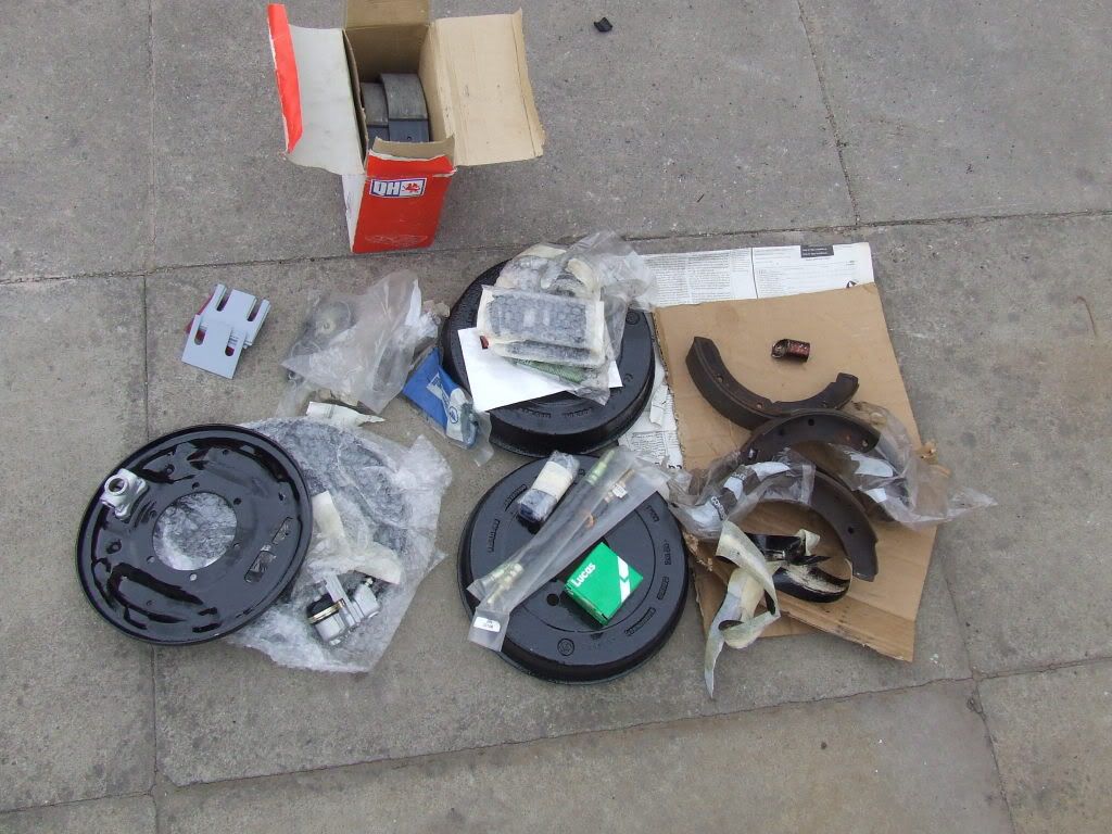

Can anyone tell me for certain that these parts are from a TR6? There seems to be a full rear brake kit

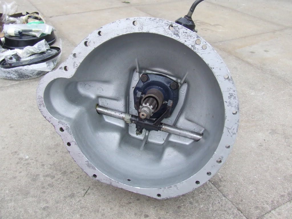

The gearbox looks like it has been reconditioned. I am going to remove the casing lid and have a look inside later on today

Looks like a TR6 gearbox to me
http://homepage.ntlworld.com/andy.jacqui/triumphs/tr6/gearbox/gearbox.htm
http://www.rimmerbros.co.uk/rimmer/triumph/tr6/gearbox-ext

It's a Triumph box for sure but whether or not it's a TR6 ? Not sure if the TR6's all had overdrive but the length of the mainshaft
may be different between non O/D and O/D boxes .

that box looks more like a dolomite o/d box
them rear drums are later vitesse/ tr6/ gt6
the rear cylinders are vitesse/tr6/gt6 ones
try going on clubtriumph website there is lots of people that will help u there
david from canley triumph is on there he will know for sure whats what.

Triumph TR6 gearboxes were numbered with CD, CC, or CF prefixes; these prefixes and the subsequent serial numbers bore little relationship to the
commission (chassis) number of the car
The box is stamped CC123909

Drum brakes look like the ones that were fitted to my TR6.
