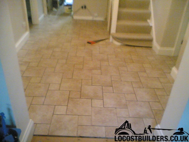

Joels fun day at work
i love my job. its very satisfying at the minute. heres a pic from today. Does anyone else really love their job?

Your not bad at cleaning Joel
Tell the tiler he missed a bit

I'm just ready for doing the very same thing Joel... whats the best thing to put down on the floor for the ahesive to stick to. Made a mistake once in the bathroom and used MDF, the relatively smooth surface and flexing made the tiles lift. Now I'm relaying them... need some good advice. Good flexible adhesive and decent substrate to lay them on.
posted on 10/9/04 at 10:59 PM Reply With Quote
in this case it was 5mm ply straight onto the floor boards, screwed firmly all over every 8 inches in squares. thats a lot of screws! i used flexible rapid set adhesive. if the floor moves the grout will crack eventually. not the end of the world, but just do as much as you can with the floor to prep it. Make sure all floor boards are firmly screwed down, check the ply for flexing, then cross your fingers!
ps, when you grout it, make sure you press it into the cracks firmly, then it will also go under the edges of the tiles and ensure maximum support all round.

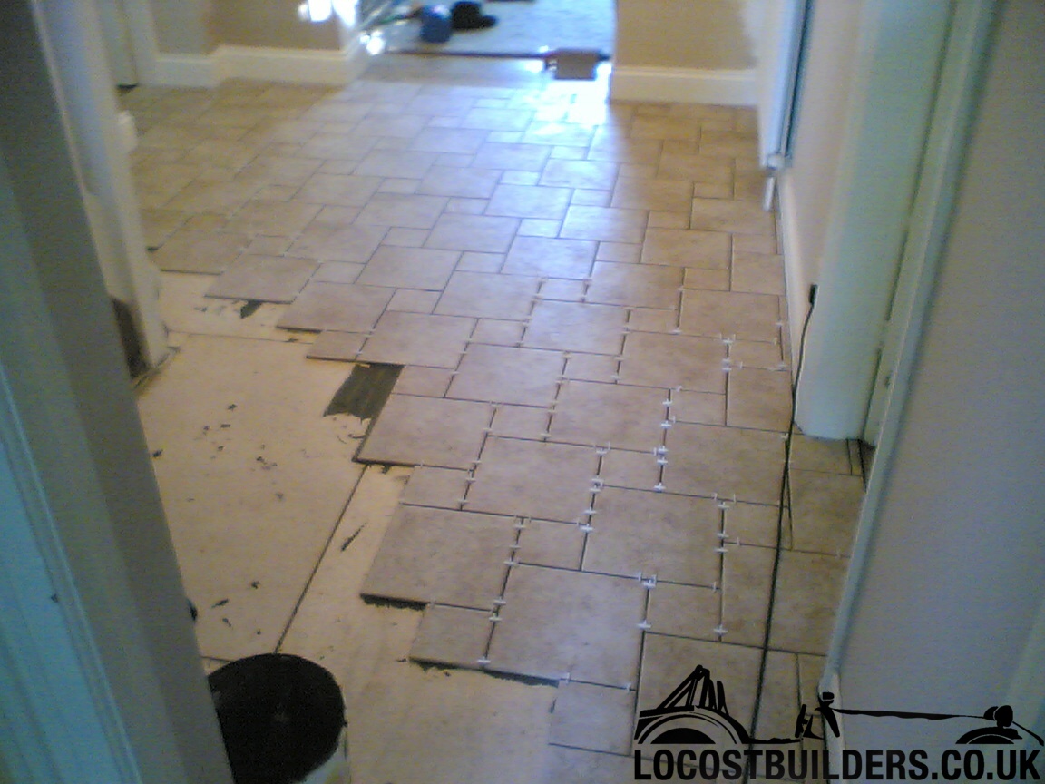

i make the grout just runny enough to pour it out onto the floor and work it in with the float! fast and easy that way. the slowest bit for me is using the electric saw to cut tiles for every nook and cranny, and of course getting the ceramic shards out of my eyes...
posted on 11/9/04 at 08:54 PM Reply With Quote
this is it before grouting. damn phone broke before i could photo it afterwards! i took these photos cos the missus doesnt believe i can do it! tiling that is...

Fine job....
Can't wait to do mine!!!
