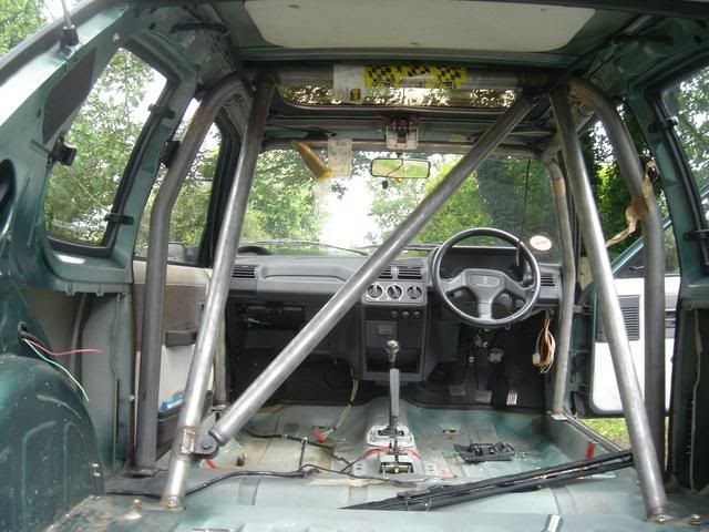

Well after a year off the road (almost to the day...) my 205 Roland Garros is back together and booked in for its MOT.
From this:
To this:
I know it doesn't look like a lot, but here's a list of what I've done:
Fitted OMP 10pt rollcage
Welded in proper seat bars
Removed all the sound deadening
Welded up sieve (floor)
Repaired rust ridden B-pillar
Sprayed floor
Cut polycarbonate windows
Made replacement roof panel
Fitted: GTi brakes
Battery Isolator
Pipercross filter
New fan
Internal fuel lines
Oil catch tank
Fire extinguisher
BX Single wiper conversion
And lots of other little things that I cant remember!
And the great thing is... I passed my test 3 weeks ago so I can actually drive it!
Plans for it next are:
Bike carbs (40mm mikunis)
286 cam / stiffer springs
P&P head
4-2-1 tubular manifold
1.6 gti rear beam
Front coilovers
[Edited on 17-5-08 by phelpsa]

If you're going to compete, you'll need a diagonal for the cage (looks like it's removable).
I don't like the extinguisher where it's hanging - it looks like it'll drop out on a bump!
Wyn
We'll be hillclimbing it.
I have all the diagonals but, as you said, they're removable and are currently removed
The fire extinguisher is extremely tight in that bracket. I mounted it there and the first time I tried to pull it out I took the dash off :O There is now some strengthening behind it and it takes a hell of a tuck to get it out!!

The scutineers will not like the extinguisher as it is! They may insist on a quick release retaining strap.
Have you got a Blue Book yet? That'll tell you all you need to know about preparing the car to satisfy the scrutineers? It's on the web somewhere.
Wyn
It's all done absolutely to the book!
I have several copies of theblue book to hand as my dad has held a racing license for quite a few years and I have had mine for a few months now
I don't need a fire extinguisher at all so the scrutineers aren't going to be too bothered that i've fitted one, and it's the only sensible place that is in reach of the driver while strapped in. It comes out fine with a bit of a tug now and I see no reason why the scrutineers wouldn't like it there tbh.
Honestly, everything I have done has been done with the utmost thought and to absolutely comply to the blue book, I've read it through, had advice from scrutineers and other competitors and have been attending hillclimbs regularly since I was 11.
I know what i'm doing
lsdweb
posted on 19/5/08 at 09:29 PM Reply With Quote
They'll be bothered by one that will come loose from its bracket in an accident!

Well feel free to come and check it if you want.
It'll be at epynt on the 22nd june
