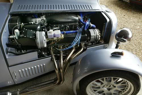

The guy who built the rolling chassis had plumbed in a non-servo single circuit master cylinder (this was a pre SVA build), although as there was no pedal box fitted I can't see how he intended to set it up.
There does seem to be an MGB master cylinder with forward facing direct servo, not sure what these come off but it might be a good idea to get one.
Any idea which car this comes from (it's supposed to be an MGB unit).
John
r1_pete
posted on 8/8/08 at 12:08 PM Reply With Quote
The master cylinder/servo in your picture conmes from a 1977 onwards MGB - rubber bumper model. I have fitted one to my 72 roadster, they appear on ebay quite often, some folk take the pi$$ with prices, quoting things like:
Rare.
Essential for v8 conversions etc.....
I think I paid £20 for mine, and about £10 for the rebuild kit.
