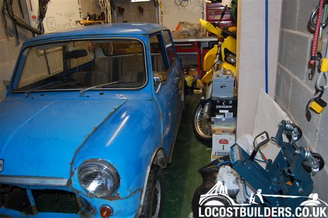

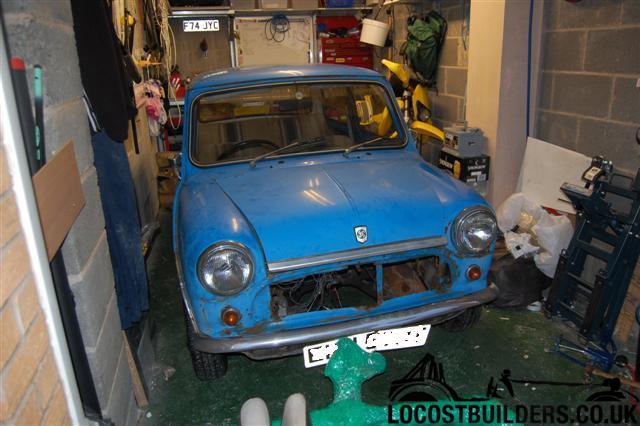

the mini!!!
finally in the garage, a new project

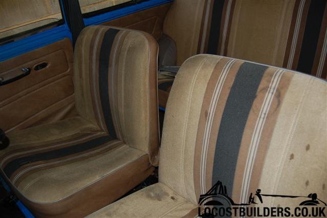

hmmmm! lovely seats! Can I have them for my Locost?

Which bits will you be keeping?

Rust bucket
I will get rid of it for you if you like Ray
That looks like a very good project keep us all up to date with this one

How much did you get that for?

I hope your gonna leave them seats in!!!

rayward
posted on 20/12/08 at 05:17 PM Reply With Quote
cheers fellas,
got a poll going on what to do engine/
drive wise but to be honest i reckon its gonna be rear (bike)engined rear wheel drive a la Z cars ( or maybe home done and cheaper)
as for the price errrr £0. was it worth it???
been stood 10 years or so since the engine siezed is pretty solid , ( for a mini anyway)
just gotta love the 70's brown interior
Ray

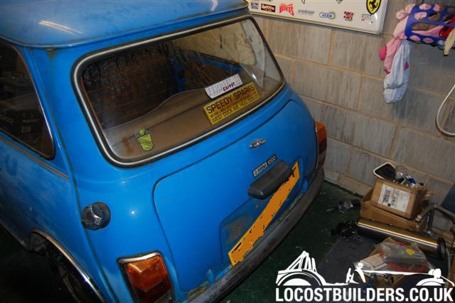

minitici
posted on 20/12/08 at 07:49 PM Reply With Quote
Just as well that mini was Ziebarted from new!
(Sticker on rear window)
Used to have a clubby estate that colour (and same seats )
