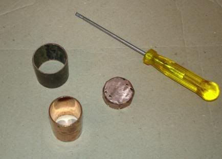

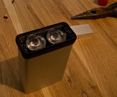

The Fisha design ™ uses an aluminium box to house the lamps but I wanted something more compact and cheaper. The hardest part was making the lamp bodies. These are made from 2 different diameters of domestic heating copper tube, 22 mm and 28 mm plus one 22 mm coupler outer diameter 24 mm). A “thimble” was made by cutting a disc from a piece of flattened copper pipe with tabs and then folding the tab over a socket.
This can be seen on the far right, the pipe joiner in the middle and the larger diameter pipe top left. The “thimble” is fitted over the coupler and is a snug fit inside the 28 mm pipe – seems like the pipe wall thickness is 1 mm. There are two pairs of 2 mm holes, one set for bolting the LED emitter and the other for wires to the emitter. M2 screws were used as their heads are small enough not to touch the pads on the emitter. Larger size bolts could be used but would require insulating washers. After cleaning the metal, the copper tubing is soldered together with plumbers solder to make the lamp housing.

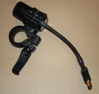

It so happens that the pipe coupler, outside diameter 24 mm, is the correct diameter for the handlebar clamps.

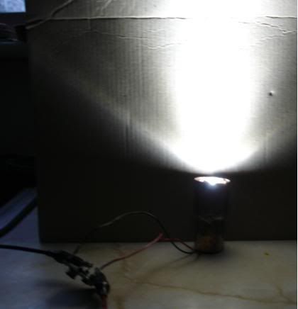

The lamp housing gets very warm when driving the LED emitters with the 5 W driver, I measured 49 C inside the lamps which although is within specification, is not ideal for the drivers. I later added an heatsink made from a disc of thick aluminium between the “thimble” and emitter as well as a short length of copper tube fitted inside the lamp. The lamps were painted matt black to maximise heat dissipation.
On my first test ride I could barely feel the lamps being warm so my concerns about overheating may be unfounded, admittedly the air temperature was around 2 C but hopefully the air flow will be sufficient to keep them cool.
When stationary, it seems the temperature rise is around 30 or so degrees above ambient so best to keep moving.

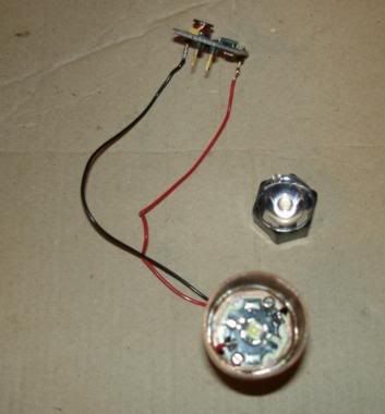

The two wires to the LED emitter were cut to length and stripped with two thinner wires soldered onto the ends. These were used to pull the wires through the holes in the “thimble”. The thin wires were then unsoldered before the wires from the driver soldered to the emitter’s pads – a fiddly process.
Photo below shows the emitter bolted down and wired up to the 3 W driver. The lens and lens holder are not fitted.
Finally the driver broad was sealed in 16 mm heatshrink tubing to insulate it from the copper pipe.
The drivers supply a constant current to the LED emitter and will work from a range of voltages, I am using 7.2 V NiMH 3800 mAH battery. The current drawn by the 5 W driver is around 1.4 A which gives a theoretical run time of 2.7 hours or 1.3 hours for 2 lamps.

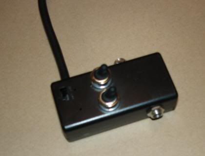

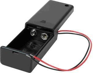

In the end I made a switch box to fit onto the handlebar stem made from a 9 V battery holder with the innards removed - the smallest plastic case I could find sold in Maplins.
The switch box has 2 power sockets for the lamps. I could have saved a bit of money by not fitting plugs and sockets but I wanted to make the lamps removable. The hole in the battery box cover left after removing the switch was covered by insulation tape (not shown in photo).

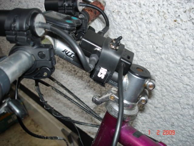

The switch box is held on by a Velcro strap and a strip of rubber with slots cut for the strap and for the switches – time will tell how robust this is.

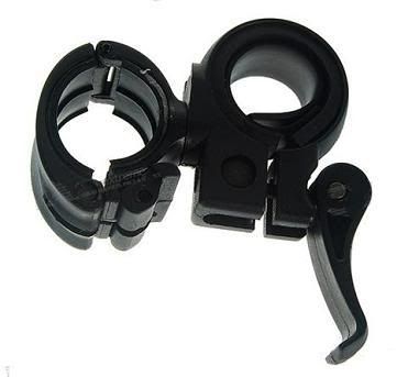

Possible future enhancement would be to use more robust mounts – the ones used are two part held together by a tiny screw to allow the side to side movement, very likely this screw will loosen. Also very little effort is needed to pull the plugs out of the socket, I may have bought the wrong ones but there is enough tension in the cable to force the plugs in. They did not come loose on the trial ride.

9 V battery case (with innards removed) Maplins L90AN £1.29

Handlebar clamps
Universal Bicycle Mount (22mm~32.8mm) Taiwan: www.dealextreme.com SKU 15342 $ 3.98
