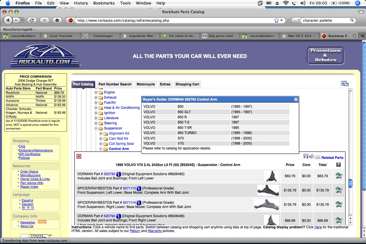

andkilde
posted on 13/2/09 at 02:09 PM Reply With Quote
Here in Canada (where snow and heavy doses of road salt are the norm) the bolts often rust themselves solidly inside the metalastic bushes and need remedial action with the oxy/acetylene torch (dirty, smelly and occasionally painful job).
Over on your side it's more likely to be a simple job to unscrew the pinch bolt on the hub, pop a great whacking pipe into the old control arm to lever it down off the hub, remove the inner fixing bolts (fingers crossed ) and replace.
FWIW, we have a company called Dorman who market very inexpensive replacement control arms (about 35 pounds for my Mitsubishi) on this side of the Atlantic -- if they sell on your side it would be worth looking them up.
t
Random Volvo Control Arm
[Edited on 13/2/09 by andkilde]
