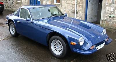

Having nearly got my 1972 TVR back on the road I am planning the next phase...
I want to include in that, an engine and gearbox swap for something a bit more modern and a bit more powerful...
The standard 2.5L straight six sounds fantastic and has a bit of torque... but it is a HEAVY engine and is not hugley "exciting"
So, what engine could I pop in there instead?
I guess I want something thats fairly common(ish) so its cheap(ish) to buy and fix...
I dont think a 4 pot would sound quite right somehow...
width of the engine bay is an issue so an shallow angle Vs are out...
So what engine should I look at?
Similar car:
My car:
