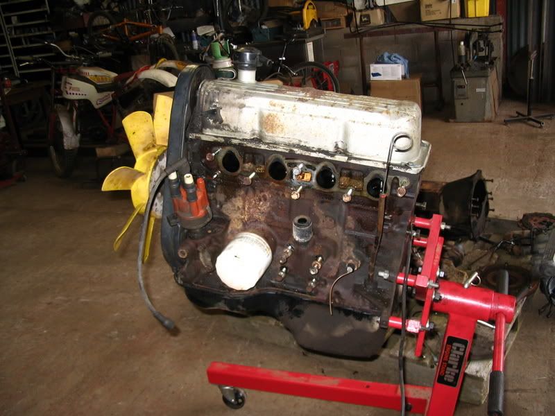

visualy EFI heads have 'egg shapped' inlets:
http://i5.photobucket.com/albums/y170/mcerd1/Dax/IMG_3846.jpg
