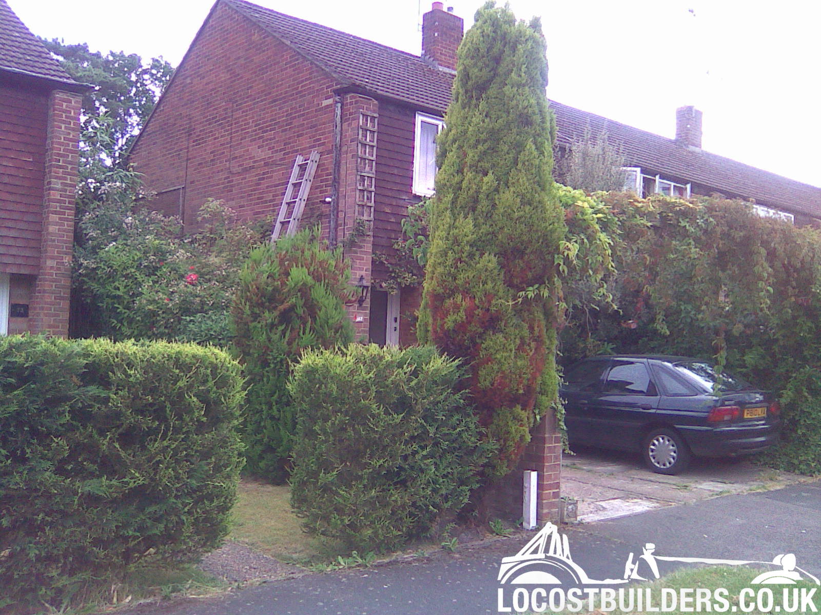

A neighbour has had this installed today:
http://www.locostbuilders.co.uk/upload/Dodgy%20Plumbing.jpg
It would appear to be a sink outlet. And it appears to be going into the guttering downpipe. I'm pretty damn sure the guttering goes to a soak
away rather than a sewer.
Is this ok? I would have thought not and was against building regs?

EDIT: apologies for size and poor quality of image! But I think it shows my point. If not I'll go on another espionage trip and get another
clearer one!

er, i'd say a pretty much definite n, that ain't right

Erm, nope, nyet, nein, non.

If the downpipe is going to a soakaway then i'd say it not right, but some downpipes do go to the sewer.
Local building control may welcome a call, I think they are short of work at present

no it's far from right , it wants connecting to foul waste, which will probably cost him a few quid if there are no services close by ... foul
waste going into a soak away is not good for anyone, how do you know its going to a soak away james???

A lot of older houses had combined rain and foul drains so you may find that, whilst it's not plumbed correctly, the foul waste is actually
going to foul drains.

Yes, it all depends on the system. My place has guttering downpipes entering the sewerage so in that case it really wouldn't matter. If it has
two separate systems then it should enter the foul system not the run-off system. Sorry if my terminology is non industry standard.

start with a call to the water board, they will know if it is a combined system or not. In my area it all goes the same way.

Presumably, being neighbours, your house is of the same construction. If you can access your drain, you could chuck a bucket in the gutter (or point
a hose up ont the roof etc etc) and see if it makes its way to the drain. If not you've confirmed it's a soakaway.
Then rat him out.

what about the build up of fat in the downpipe. Where does you sink run into??
My house has sewer, waste and soakaway 1920's property. you cant mix and match the different wastes.

Even if you have a combined foul and rainwater system, you still can't chuck foul water down a rain water pipe.
Foul can go into a soil stack, or straight into the gulley at ground level.
I'd get the LA Building Inspector round, especially if you don't like the bloke.
