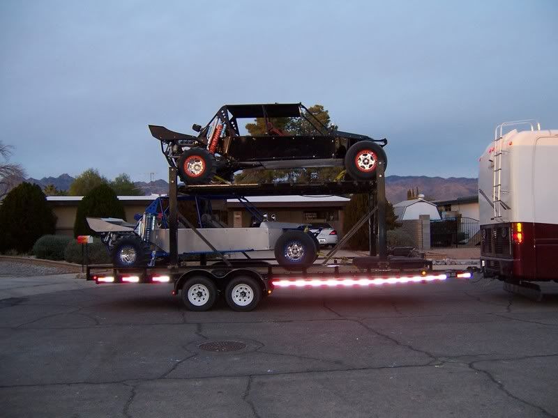

Iv been looking at these and was quite interested but they want 12000 pounds +vat.
Does anyone know of anything similar i could also look at?

Interesting idea! I can't see them being cheap either. Custom made trailer that will take the weight. Then a scissor lift.
Cheaper is going to be http://www.hamercarlift.com/ and a flatbed trailer!

thats going to be a very heavy trailer to tow
what about a normal tipping trailer with a car trailer deck instead of the flatbed type. That way you could tip it up, lock it with a bar or such thing and work under it.

Could you not get a lightweight 2 post list and bolt it to a reinforced flatbed?..... With some nice big feet to stabalise it?
None of these solutions would work well if atall on a slope...

Yeah. Its for my new mobile servicing business. I think it looks much more professional than using axle stands and should help get my business noticed.

I was looking into doing that but looking at all the safety checks etc it would need before it was used, i think it would be better and safer to but one professionally made.

I think the idea of a trailer lift is better than the machine actually is!!
Think of all the jobs you CAN'T do with it? That includes exhaust work or any jobs that entails lowering the exhaust. This would probably mean any work on subframes or bushes will be a no-no and probably a lot of clutches.
Brake or fuel pipes. I doubt you'll be able to get to them once it's airbourne....
Any work that requires you to swing on a spanner/breaker bar. I'm sure the whole thing would sway like a drunken aunty without too much provocation.
As the rear of the trailer is fairly high, the ramps are steep. This means you'd have to use longer ramps to get a low car onboard.
And, does this device fulfil all the Health and safety gubbins? Check out the LOLER and PUWER regs.
I'd be more tempted to invest in a decent van with a fold out rear and side awning. It rains far more than you need to be under the front or rear of a car.....

If it was me i would make long and strong ramps for the trailer and a stand for the rear most of the ramp so you can have the car on the trailer and reverse it onto the ramps which are raised so you can get underneath.
