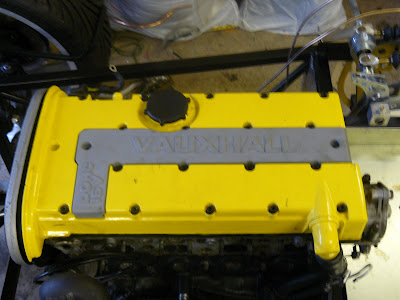

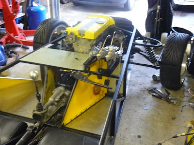

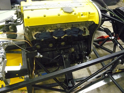

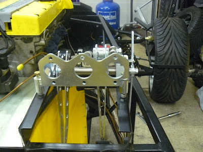

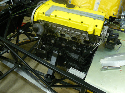

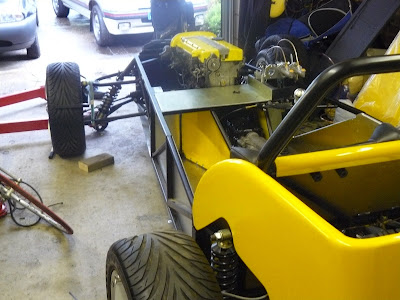

These wont be making their way onto my blog because they havent come out well, but thought maybe, possibly people might be interested in an update:
LHS snazzy mount
RHS snazzy mount
After cutting out a chassis rail
Trialing the pedal box
my first ever fibreglassing attempt (ugly but functional)
Will be replacing this with some snazzy CF but its not top of the purchasing list..
Overview
From the back

what radiator is that?
you engine is very very close to the engine bay back panel isn't it
don't forget to put a panel across the pedal box whole otherwise your feet get VERY HOT VERY QUICKLY! mine still do and i have a panel there
too!
you running sierra LSD or english axle?
looks very tidy mate, keep up the good work

hmm yes its about a cm away from the rear engine bay chassis rail. The mounts are firm as anything though, so fingers crossed and no racing over speed
bumps
Its a 3.62 sierra LSD.
I've got some checker plate, itll be difficult to put a box over it though because the accelerator pedal is on the outside of the mounting
brackets as shown in the 3rd picture.

Just a thought Alex, the inlet is on the drivers side, so it shouldnt be too important to seal that off should it?
Thanks for the nice comments boys.
Craig
omega0684
| posted on 27/7/09 at 11:12 AM |
oh yeah, you might be alright then, but my feet get very toasty on long runs it can get a little unbearable, but i have fitted exhaust wrap since i
last went out so it shouldn't be that bad now i hope,
with regards to the accelerator pedal, you have to cut a hole in the little right angled aliminium piece on the side to fit it and you also have to
cut two rectangular holes for the brake and clutch pedals in the top cover

You say you cut a chassis rail out?? You would need to put it in there somewhere again if it was the top bit.
Dan
cd.thomson
| posted on 27/7/09 at 04:00 PM |
if you compare the second and third photos you can see the tube i chopped, its the round one below the clutch cable.
I can't see a way of replacing it and it doesnt seem to provide any direct support for anything structural.
The dax is know for being over engineered but if you can see a way to replace it (and think its necessary) then give me a shout
