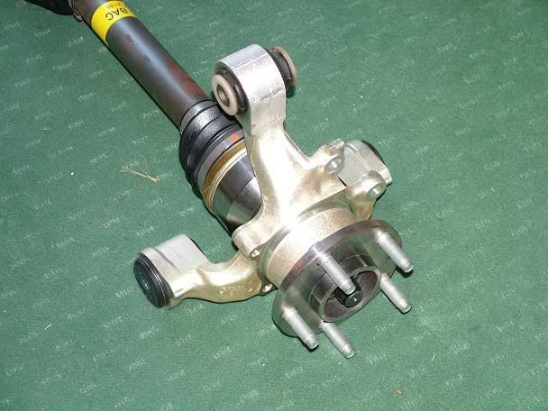

ford thunderbird rear uprights

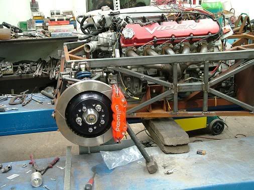

330mm discs with 6 pot calipers

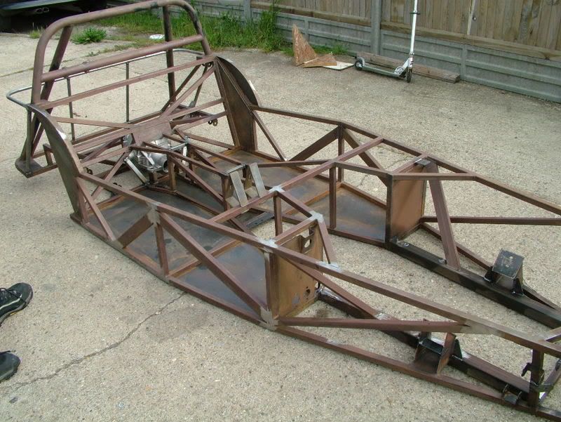

original chassis as supplied by luego
and the heavily triangulated chassis after my mate sorted the strenth, note in the second pic the door to rear arch area changed for extra strenth, also top rail is 2x1 on its side to give and extra inch so the engine fits under bonnet.

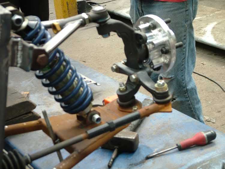

wilwood front mustangII uprights, and hub

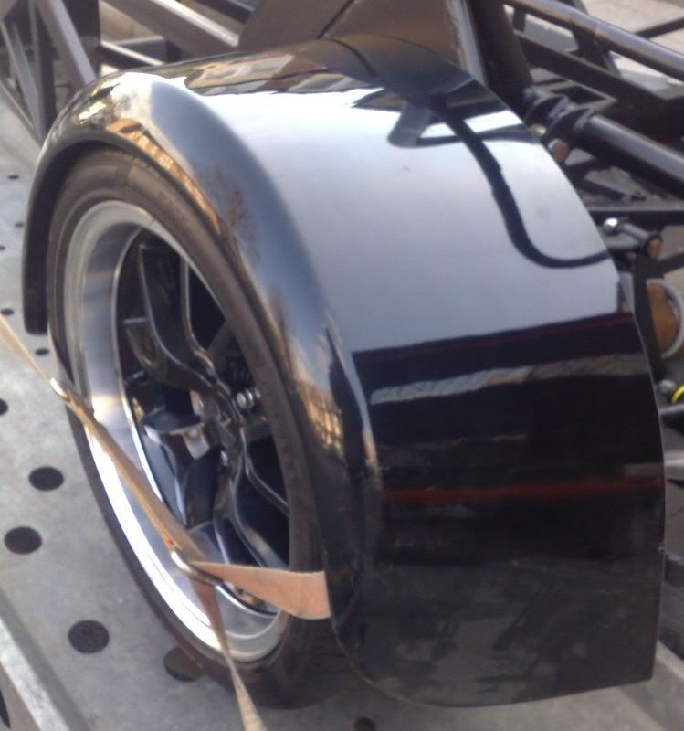

wheels are mustang FR500 replicas 9j x 18 front with 255/35 18's and 10j x 18 295/30 18 rear
standard rear arch looks good with a 10j under it, fits perfect

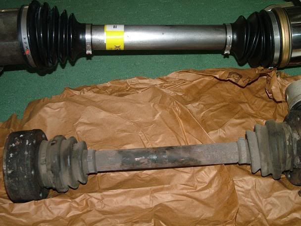

standard cosworth sierra drive shaft looks a little anorexic nect to my cobra mustang shafts, the pic doesn't show the size difference as much as it is, and to lift one, they are solid and weigh some.

its come a long way, the car i took to Newark was the weak luego chassis before my friend worked his magic, it was unpainter, was running granada hubs, it was lashed together to show the engine off at the show, and I wanted it on wheels to make moving it easier, you saw it like this.
