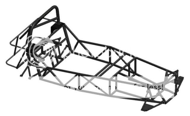

wescottishmatt
| posted on 24/8/09 at 11:44 AM |
When I was doing this I used a series of solids created from a master part and just created a series of small sub assemblies and then joined them all
together. I would try and avoid the 'Configurations' route unless you use it regular. it seems to get a bit messy very quickly.
As said above it can be done in a few different ways but all with the same end result. As for which is best I have no idea.
There are some later images in my photo archive with panels and a bit more work done but its nowhere near finished. I just don't have the time
to get any further with it yet.
