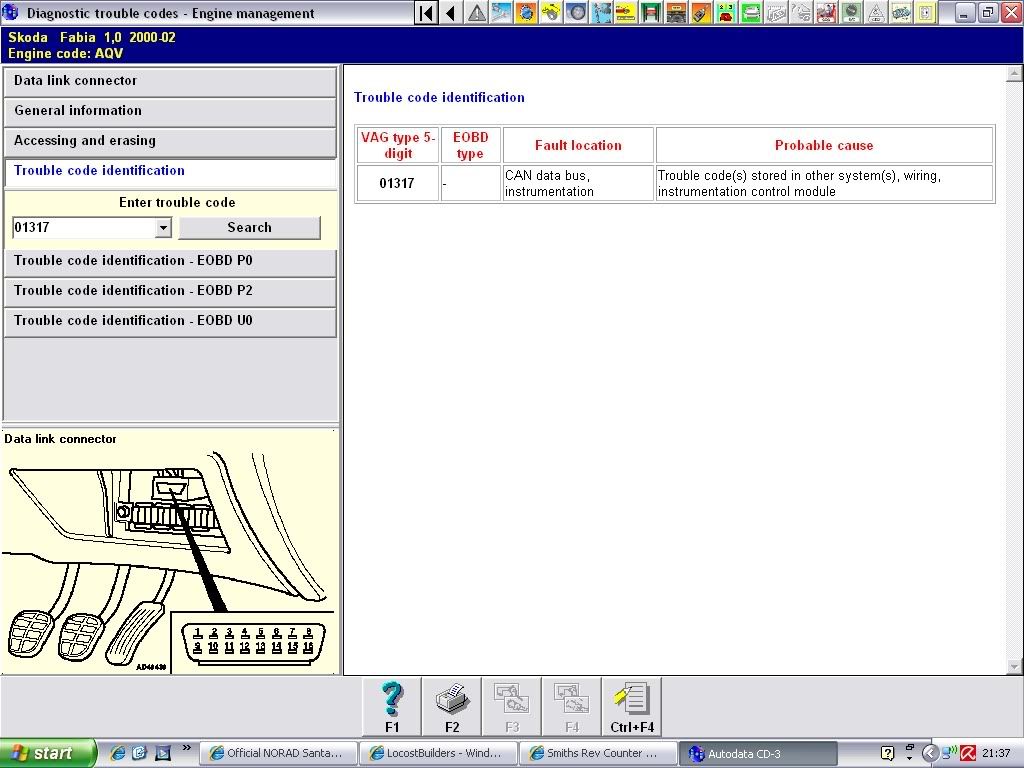

| posted on 10/12/09 at 09:35 PM |
hi there..
u2u me with the vehicle year and what engine as i have fault codes list in my auto data software
boggle
u2u me for details
m8kwr
| posted on 10/12/09 at 09:38 PM |
Thanks, U2U sent
