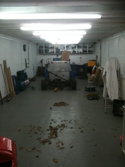

froggy
posted on 6/7/12 at 04:52 PM Reply With Quote
you lose a little space going cavity and need to add insulation but its well worth doing . i did mine exactly the same spec as a house so has floor insualtion ,cavity bats in the wall and kingspan solid boards in the roof . i have an old combi boiler and a few rads in my 60x18 garage and it doesnt take long to heat and keeps the heat in pretty well

gregs
posted on 6/7/12 at 05:21 PM Reply With Quote
Any idea how much more it cost to put together? My view is if i'm doing it, i might as well do it right.... prob leave out the roof insulation initially (as easy to retro) but floor and walls are not retro fitable so....
