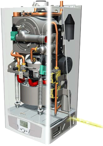

Has anyone had experience of this type of boiler
OK Need a new boiler asap
http://www.britishgas.co.uk/products-and-services/boilers/boiler-service/boiler-range/ecogen.html
is this any good? I like the stirling engine idea
Are british gas as an installer a good idea ?

Thats the Baxi eco gen it generates a kilowatt of electricity every hour the heating is on. The Stirling enegine is rated at 8kw I think and all up
its a 24kw boiler.
The stirling engine acts as lead and the gas boiler as top up.
You can claim feed in tariff if it is installed by an MCS approved installer.
They are quite noisey howver so need to be installed out of the way.
We tend to specify them for people who have swimming pools as the stirling engine runs all the time offsetting pool losses and generating the maximum
tariff.
Quite expensive think they are around £5k

thats a micro chp unit, Baxi are now a part of BDR, Baxi, De Deitrich, Remeha.Andrews water heaters are part of the same group and I think its being
sold through them but with a Baxi badge,
I've seen that unit working in Remehas factory in Holland.It is very heavy! Must be fitted on a solid wall,IIRC there are only 3 or 4 fitted in
the UK so far, your gas bills will go up slightly but your electricity bills will plummet.
Also quite noisy, I can get you more details if you like.
