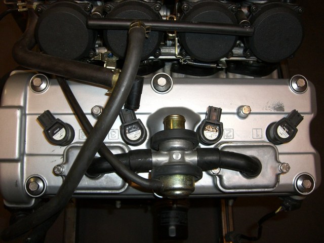

I have a Lucas/Protech ex MOT analyser, I have a friend with a MOT garage, he gave me his old one on permanent "loan".
The air injection valve is the one in the centre of the cam cover, it's connected to carbs 1&4 vacc ports.
![](/galpreviews/Air injection Valve.jpg) ![Description](/gallery/Air injection Valve.jpg) Description
You had one on your engine,photo from your archive
![](/galpreviews/CIMG0643.JPG) ![Description](/gallery/CIMG0643.JPG) Description
You can see the difference it made with these before and after shots.
![](/galpreviews/Before air valve.jpg) ![Description](/gallery/Before air valve.jpg) Description
![](/galpreviews/Readout.jpg) ![Emissions](/gallery/Readout.jpg) Emissions
The carbs seem to be running on the rich side, the air injection gives a leaner gas before the cat.
