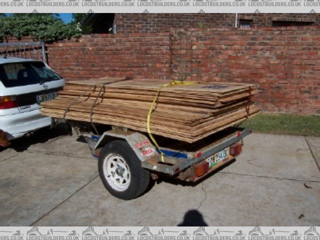

I've put this in non car section as the trailer is a utility type, as per picture. Trailer was originally built to carry a race Kart and equipment, now gets used for hauling all sorts of stuff.
Finally decided I need to replace the tyres, wheels are 13" x 6J. Going to go for a cheap and cheerfull brand, but what size tyres should I spec? Want something fairly heavy duty as it uses the axle and springs from a half ton (500kg payload) pickup so can carry quite a load. Also it needs to be able to be used at motorway speeds.

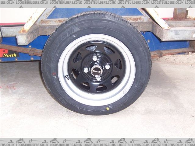

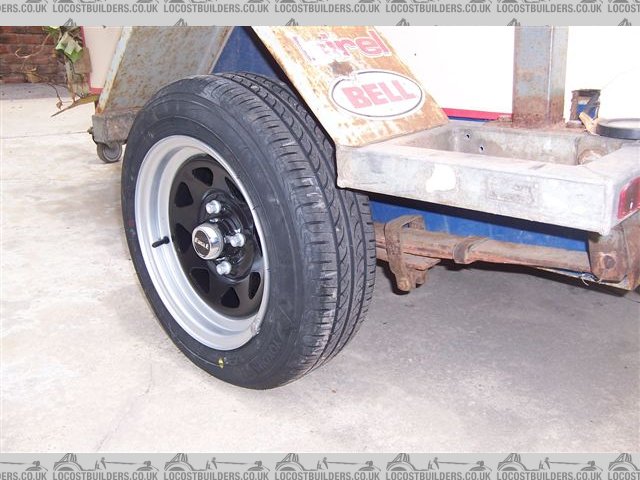

Eventually went with a 165/65 Yokohama car tire. Load rating is over 400 kg per tyre. Expensive tyre for a trailer but the cheaper tires had a higher profile so would increase the already nose down attitude of the trailer when hitched to my current car.

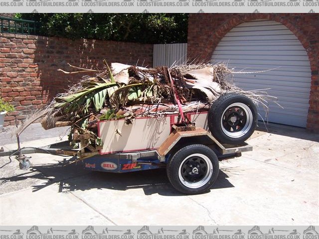

The spare tyre has 2 functions. When the trailer is empty and the removable sides are not fitted I can't see the trailer from inside the car, so I added the spare sticking up at the back to aid reversing.
