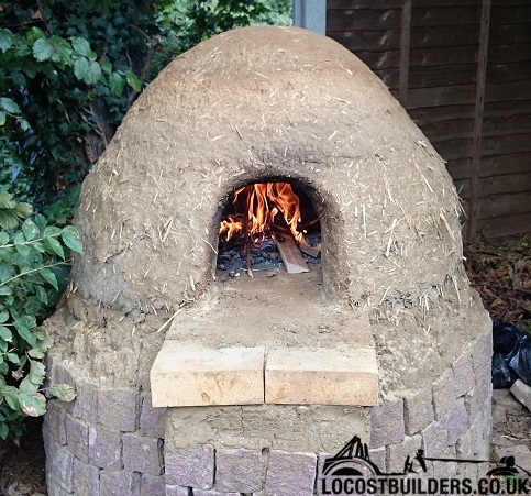

I haven't done much on the car this year but I got to fire my cob oven up yesterday to get it ready for its first pizza
just waiting for the pizza peel and regardless of rain or shine at the weekend its a pizza time.
got to tart it up a bit the girls want to make it look like a beehive and then a lime plaster and it should look

What's the dome made out of?
How did you get it to stay in shape?
How long do you think it will last?

The setts were cheaper than the firebricks at £135. It's cost about 300 total so not locost at all.
It's made of two layers each about 4 inches thick. The inner is adobe 33% clay mixed with sand, the outer is cob which is adobe with straw
added.
You build the whole thing on a sand dome, let it dry a bit then cut the door then pull out the sand. Then fire it for 8 hours or so to harden it.
Once lime rendered and finished it should last a long time as it sets like concrete as it gets over 400c internally supposedly.
