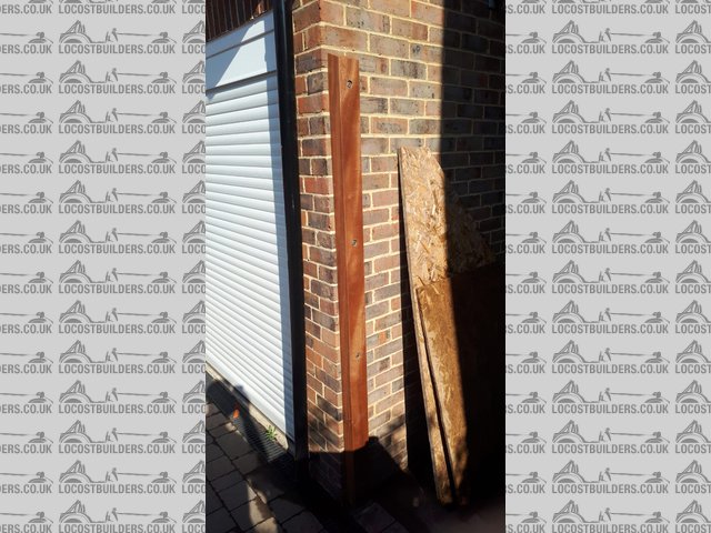

James
| posted on 18/5/21 at 02:41 PM |
Hey Folks,
Thanks for all the helpful responses- does Non-car Chat not appear in the recent activity list?
Anyway, out of (for once) not wanting to buy an extra tool/tubes I thought I wouldn't use very often I went with the concrete bolts instead of
the apparent concensus- the resin.
Bear in mind I was doing it in the dark and rain (and as usual I made my tolerances too tight) it went fairly well and the post appears at least to be
fairly rock solid.
[img]
[/img]
I'm sure you'll all be fascinated if I put up a picture of the finished gates so will do that once they're done!
Thanks again!
