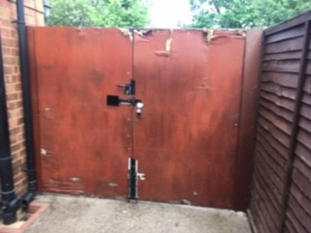

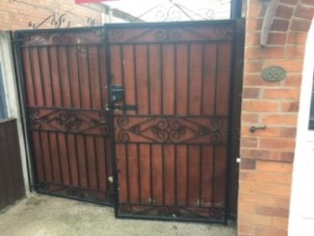

Calling on the genearl LCB public here for inspirtation, expertise or any other input
As below my gates need some new screening panels on them.
They are currently rotten plywood, I'm looking for other solutions that dont cost the earth, easy to work with, low maintainance?

replace the existing screening panels with feather edge fixed to a couple of battens, like a fence panel. Tanalised timber, should last a decent time,
especially if coated. I've been using barratine wood preserver from toolstation - makes the timber nice and water repellent without the
maintenance issue of paint, and you can slop it on with a 4" brush really quickly.

Hi, sorry if it wasnt clear , its just the pywood I want to replace the gates are fine save a coat of paint.
I've seen them dobne with some sort of black "perspex" but thats hugely expesive, so rea;lly looking for other material options

Sheet steel and a welder?
| posted on 4/7/21 at 04:00 PM |
Perforated steel sheet? I've seen that used to back up steel gates and it can look very tidy.

Sounds like the solution I'd go for. Pressure treated vertical feather edge boards on some horizontal battens. Got the same garden fence.
Lasts a good time with minimal maintenance. Easy and relatively cheap to get the timber and DIY it too.

Thanks guys, the perforated steel looks smart, but I think I want to keep it not see through at all. Mr Kentons stuff looks just the sort of
possibility I had in mind, so I will look into that more.....
