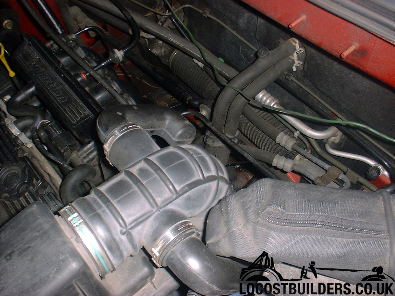

on my Dads freelander, there are 2 pipes on the pipe between the airbox and the plenum......what are they for...any ideas.
http://www.locostbuilders.co.uk/upload/freelander%20airbox02.jpg

They look like resonater pipes but why theyr in that pipe and not the side of the airbox i dont know.

I think one thing that these sort of things do is stabalize air in the plenum. They may help with induction roar aswell

As its a free lander, there may be a poss that a different and larger air filter can be used for desert and hotter countrys, and they may just use a common connection pipe for all models.

There to stop engine hunting when the throttle is closed quickly. (air charge bounce)

Loads of Jap stuff has pipes like those, I assume they are to cancel some resonance from the intake but I dunno really.

Helmholtz resonators to remove/attenuate certain frequencies from the induction noise. Virtualy all production cars have them these days in order to pass noise regs.
