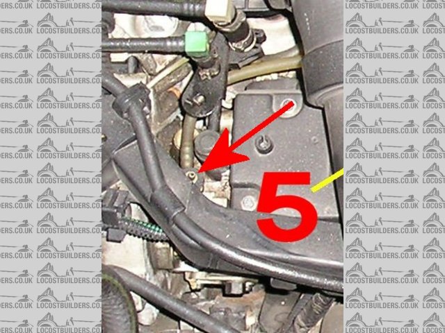

Number 5..... I have air in one of the rigid clear fuel pipes and it moves along when i pump the rubber bellow in the top left corner of the picture.
How do i rid the line of the air? when i pump it, it just moves along and the comes back down the pipe.

5. The air is in the top of the filter and will not do much harm there. I cn't remeber for sure, but if you turn the canister upside down is
there a drain plug that you can use as a bleed?
How do i rid the line of the air? when i pump it, it just moves along and the comes back down the pipe. ------------DON'T worry about it it just
helps to tell you if you've actually got fuel in it and its flowing.

Jolly, I occasionally have a problem with it starting, maybe once a month it wont start, turns over fine but needs maybe upto 5 cranking sessions to
get it going, could this be due to the air in the fuel?
Here is the bleed screw for the fuel........i think!
  fuel bleed
[Edited on 28/12/06 by locoboy]

Is it puffing out white smoke while you have to crank it over? If yes then I'd check the glow plugs as this is a sign of unburnt diesel. If
there is no white smoke, then you could try bleeding it, but I'd be inclined to check the glow plug wiring first and check the controller as
well.
