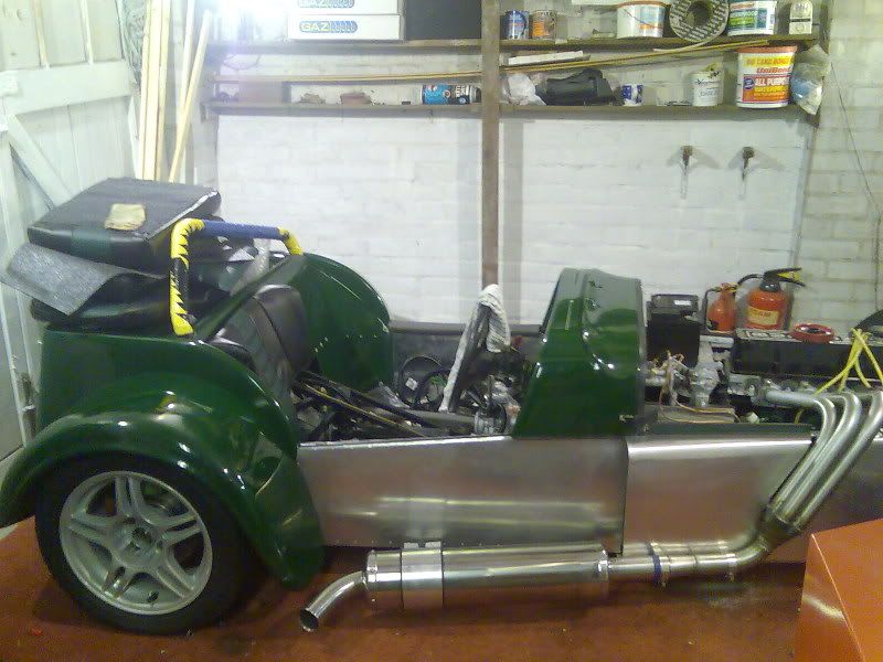

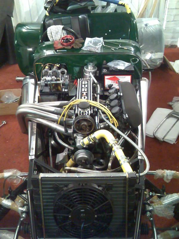

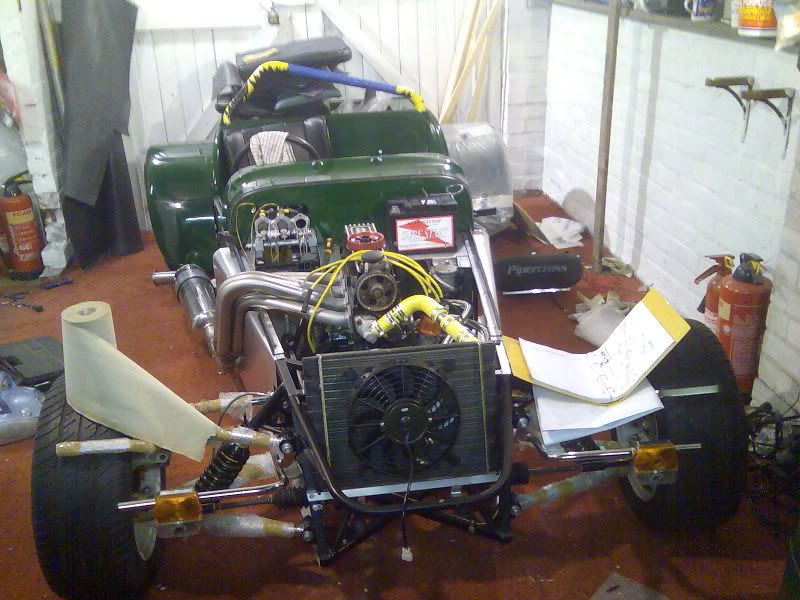

brief build update.
a big hello to you all!
first let me say that i hope that you all had a fantastic christmas and a happy new year.
i was working all over christmas and i was on call from the 22nd of dec till the 5th of jan so it was a bit of a quiet festive period for me but an
extremely busy time for work. so as you can imagine the build had to take second place, much to my dis-pleasure!
BUT! im happy to say that i have started to build again, i have got garage heater for chrimbo and now my garage has become a sauna! i have uploaded a
few pictures on how my build is going,
here are a few photo's, all comments welcome,
next big step is getting the alternator in and getting the loom done (my worst fear about the build)
how are your builds coming on?
kindest regards
Alex

Those exhaust primaries look massive
what diameter are they?
Looking good BTW

| posted on 17/1/07 at 09:39 AM |
Looking very smart!
Just one observation, which you can read or ignore at your pleasure...
Does the bottom of the silencer hang below the floor line, as it appears to in the photo? Just that ground clearance is always an issue with these
cars, especially when running with a passenger, and it may end up banging on the bumps!
(but there may be more clearance than appears in the photo).
Nice work though!

1)Rob (mercd1): mate i have used the vicki green pinto loom for the DAX, then im going to add in bits that are missing or extend exsisting wires etc.
i think that the DAX loom is FAR to expensive for what you get. V.G loom = £50 from stoneliegh DAX Loom = £300 +VAT
2)dave (big booby bouncing fitty) the primaries in the manifold are 2" diameter, and the inlet to the silencer is 2 1/2" so the pipes get
bigger
3)dave (chimp with funny hat) the silencer does hang below the floor line of the car but no more that the sump and gearbox, i must admit that i have
noticed that it is quite low,but i will see how it goes and if it does become a problem i will have to put your chimp thinking hat on and start
scratching my head

Its an MK pinto manifold the same as I have fitted to my pinto. They are pretty big!
Looking god Alex, you shoulda fitted the alternator before the exhaust though, bit of a pain afterwards!
Good luck with the wiring, I have been a bit rushed off my feet this term so havent had chance to get down and give you a hand. Sorry mate
How close are those primaries to your flared bodywork? They look a tad close in the pics, could just be the angle though.
[Edited on 18/1/07 by flak monkey]

Coming along nicely alex. How do you feel about the somewhat optimistic roll bar? I've always thought the dax bar to be a bit short.
Sun Tzu, The Art of War
omega0684
| posted on 18/1/07 at 09:57 PM |
well si, when i sit in the drivers seat it goes above my head, so im happy! not to sure about the passenger tho
DIY Si
| posted on 18/1/07 at 10:05 PM |
You know the answer to that then! You having a windscreen or just an aero? I'm surprised that goes over you're head, I thought you were
tall?
omega0684
| posted on 18/1/07 at 10:17 PM |
im 5'11", to be honest i will probably get a screen but at a later date. i want to see how bareable it is without one first, plus its
easier to pass sva without one
DIY Si
| posted on 18/1/07 at 10:26 PM |
I think it depends upon the type of screen. Mine looks ok, but is useless, as it just lifts the airflow to my chin, so I still have to wear a helmet.
A lower/steeper one might look better, and be more effective.
