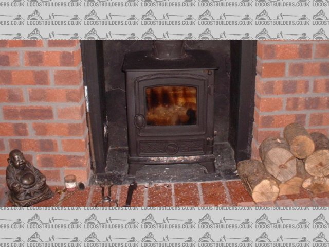

| posted on 28/2/07 at 10:38 AM |
If it's plaster over 4" brick or block you will be fine, just fit a stainless flue liner. I fitted a small multi fuel wood/coal or coke
stove a few years ago and it's not burnt the plaster off the chimney breast above it yet. Here's a picture (not cleaned up from last night
[Edited on 28/2/07 by Peteff]
