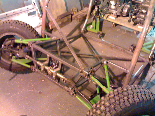

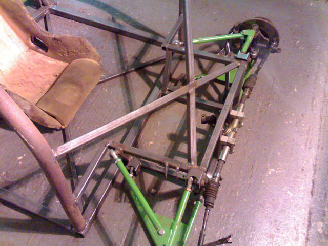

Fiat 126 twin BEC grasser progress update
Just a little progress update............................
have cut the car up and abandoned the project......................................
not!!!!!!!!
Not long got in from the garage, decided its a bit late for the angle grinder now!!
here's a piccy or two, sorry I'm no photographer!
  front 3rd march
  front built up
  6th march progress
and yes, for those not in the know and who were wondering.....the shell is lifted off again at the mo and sat in the garage to one side!
Its really dawning on me now how bloody small the little blighter is!!!!!
To give some idea, its 72" front hub centre to rear hub centre, and 67" track
