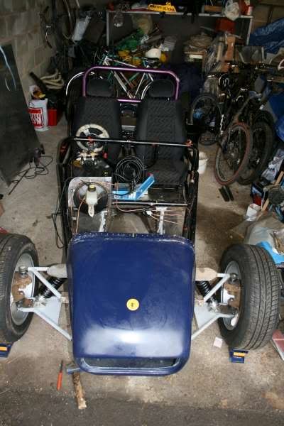

can some one please put me out of my missery, a part build listed on ebay 130114989282 listed as a 2B, however this car has Mc pherson strut front end, which i thought was a SUB-K, as 2B was double front wish bone can some one either agree or correct me

Yup...they did a couple of 2b versions...
I believe the first one had sliding pillar, the second had mc-pherson strut thingies and the latest has double wishbones....

Monocoques in stainless were the first upto and including the Series 3a after that it was the 2b, subk was marketed at under 1000 pounds with fixed top mount for the mac strut, there was also the delightfull (not) sliding pillar ala Morgan.
GBS do a good wishbone conversion.

The sliding pillar uses the inner steel bar cut out of the mc Phearson strut and its a bloody pain and needs far too much maitainance, the chassis is very heavy, the stainless will rust, mine was rusting when i picked them up from the factory!
The rear suspension uses the sierra trailing arms so again very heavy.
None of the panels will fit properly, the build video will have you wetting yourself laughing but for all the wrong reasons.
I must say though that there are some truly great examples out there thanks to some VERY talented builders.
I cannot say much about the latest 2bs, maybe the quality has improved but the one you are looking at is an early one so will deffo be shocking, stay away mate.

I suspect its just the angle of photography but the whole front end looks like its shunted a foot to the left in the final photograph.
I would suspect the only plus side on that kit is that, if the suspension is on, then at least the brackets are either OK or have been sorted out.

It is possible to "fix" the front of the 2B chassis....but it would have been easier to just buy a new chassis from a proper manufacturer to start with....
This started life as a sliding pillar...

it's a 2B/4, I know coz I've got one - built from start, 2 yrs - most time spent re-fabricting the RH parts that didn't fit (such as the fuel tank!). While I'm pleased with the finished article it's very heavy for what it is and the front suspension (uses all of the sierra suspension hardware WTEO springs and dampers) while ok has very limited adjustability (tracking and camber), and worst of all the shock is a butchered mini item meaning I can't change them without a total hackup. Whilst I learnt a huge amount building it, I think it is a total false economy, too many bought parts going in the bin!, I would never recommend to anybody - better to build a chassis IMHO.

Hello.
I'm sorry but it's not a 2B/4.
It is a 2B with sliding pilar suspension.
Which is the worst of all the 2B's. However it can be chanced to double wishbone.
I know because I built and owned a 2B with sliding pilar and converted it to wishbones.
The 2B/04 looks like the sub K with the headlights a lot higher than the one being sold on E bay.

don't be sorry - you're right, i'm wrong!.
Defo a sliding piller.....I just needed to open my eyes..
Am considering converting my 2B/4 so dbl wishbone (watch this space!)
