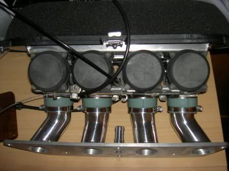

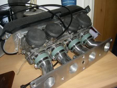

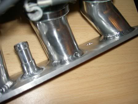

Just a few pics here of the bike carbs i got for my pinto a few weeks back from boggs, Stephen is a great guy who also fabricated up a handbrake and gear stick surrounds. They will be going on after sva to replace the current pierburg carb. Sva is only 2 weeks away now!!

Just thinking, can anybody confirm these are indeed R1 bike carbs?

They look similar to the Kwak Keihin CVH's i have for my car - but then if the R1 uses Keihin then that wouldnt be a shock. I thought the R1 had a TPS on them - maybe only the newer versions.

They are bike carbs (similar to R1 Mikuni CVs). If R1, they will have had a TPS fitted, but it *may* have been removed if not needed as they aren't a permanent fixture.
Nice quality fanimolds (and just down the road from me!).

There is one thing those pics prove if i see them right - the float bowls dont have to be level when fitting bike carbs. im now kind of wishing id kept the carb tops level with rocker cover now for a potentially neater fit.

The top of the float bowl should be somewhere near level, otherwise you may have carburation problems (flooding or running lean).

i got an email back from steve at boggs today (great chap)
my carbs are from a kawasaki zzr1100

Well that explains the striking resemblance to my carbs then
