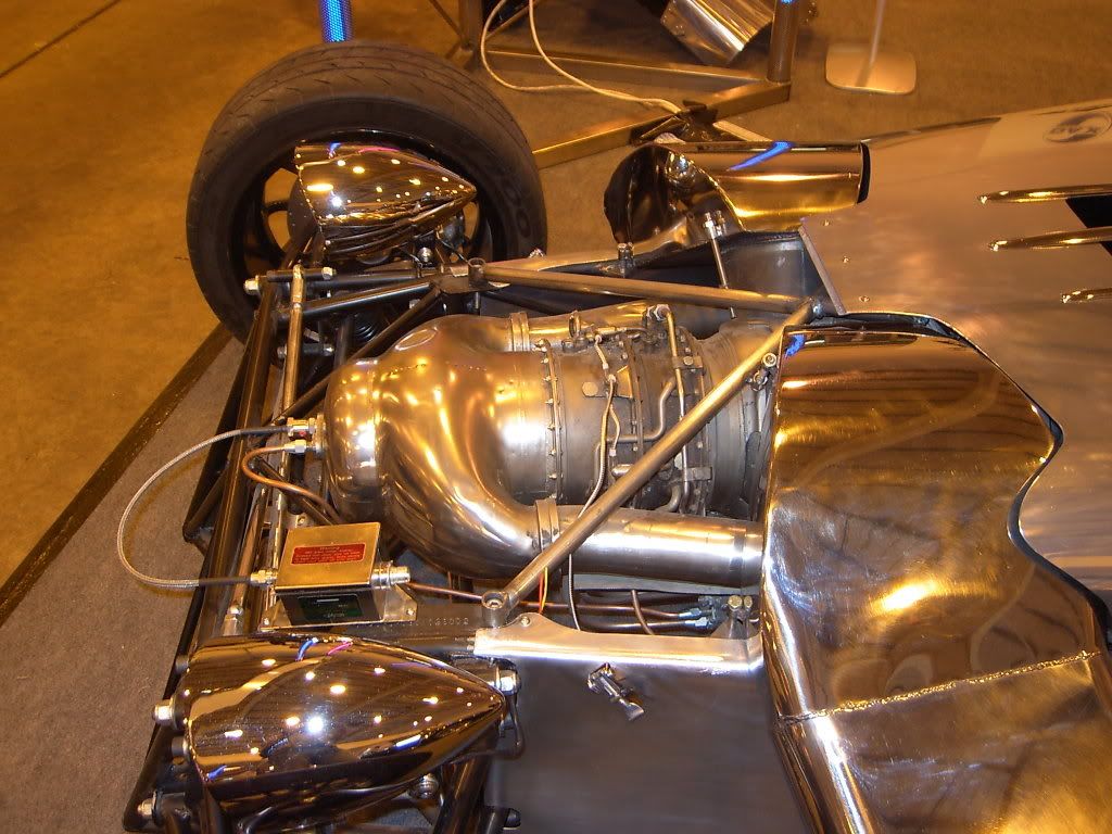

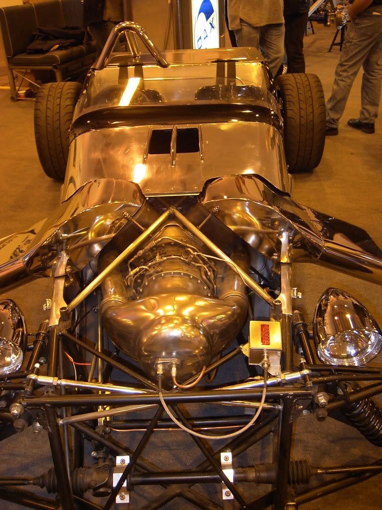

These are from Stoneleigh this year.
http://i189.photobucket.com/albums/z282/adrianthorp/stoneliegh1.jpg
http://i189.photobucket.com/albums/z282/adrianthorp/stoneleigh3.jpg
