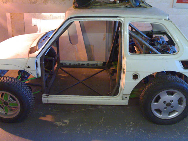

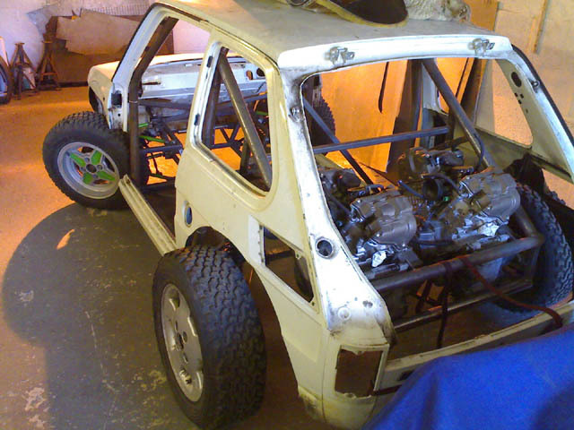

ahem, yep I do need two engines, either that or make it weigh under 300kg, which I can't do within the regs.................
there pics were taken a long time ago, much progress has been made now. Just about to actually get on to ordering two DTA S60 ECU's to run the engines..........
Should make 300hp fairly easily, and I certainly won't make the power to weight with one engine without lightening my cage much more than I would want to given the proximity of the post and wire fence!!
Hoping to hit an all-up weight of 580kg, but I fear it'll be a smidge over 600 when its done.....I can still lift the front by hand (juuusstt! ) at the moment though.
Certainly much lighter than a std 126, got one outside waiting as a spare shell donor and its much heavier even without doors or interior. Just got my Kirkey ally seat for christmas which is nice, thanks mum and dad!!
shell on rear corner

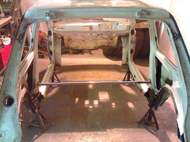

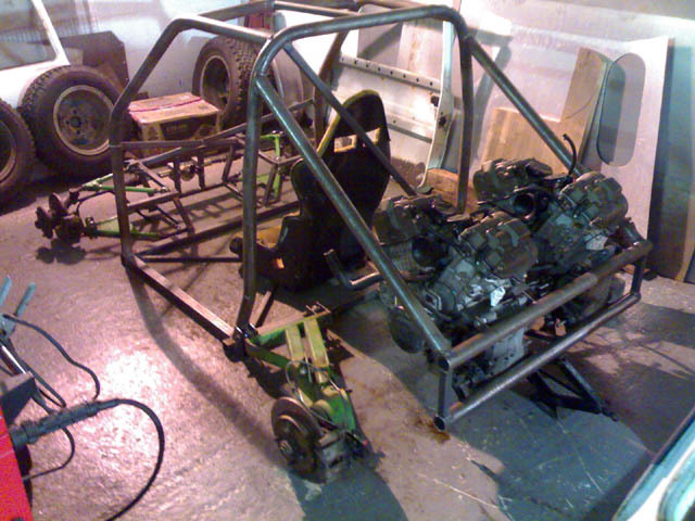

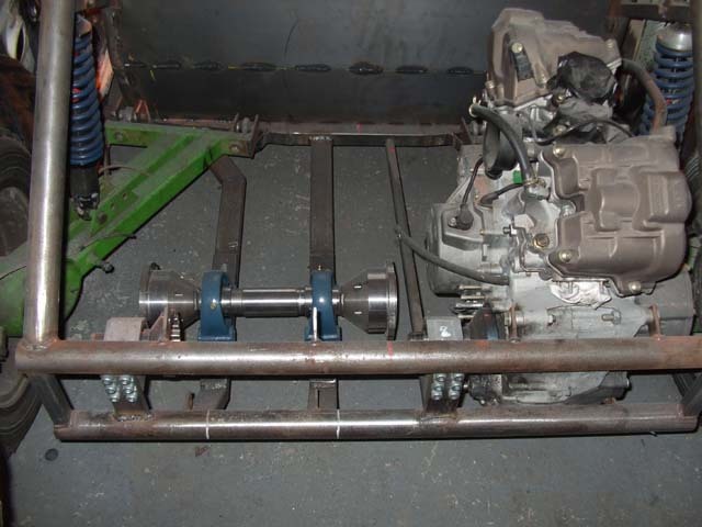

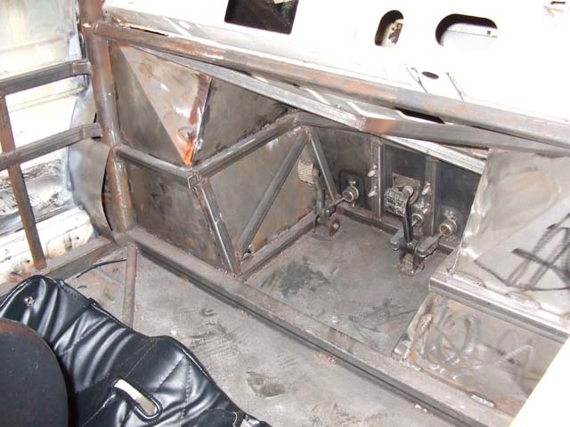

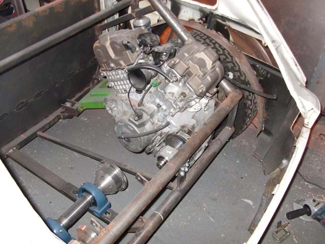

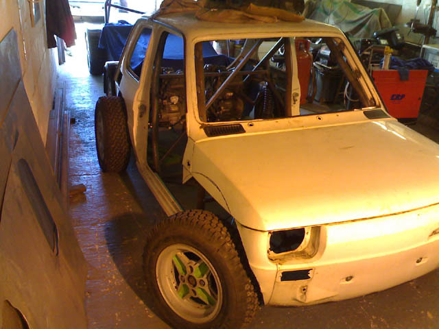

Ok, long delay as usual with me, but actually took some pics over christmas, even if I didn't actually get much done!!!
Note there's only one engine in it at the moment as the other was getting in the way!!
The arches at the front obviously need some finishing and there are side sills to go on yet that span between the front and rear arches.
Fiat 1 engine Dec 07
Fiat bootspace Dec 07
Fiat footwell Dec 07
Fiat OS Dec 07
Fiat OS Dec 07
Fiat rear corner Dec 07

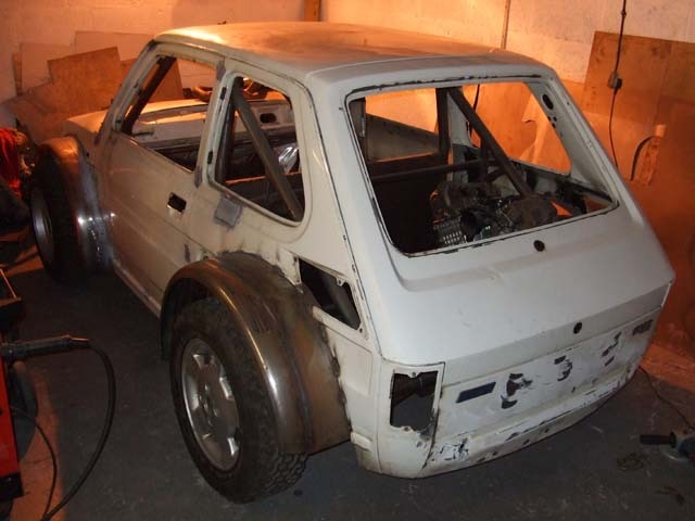

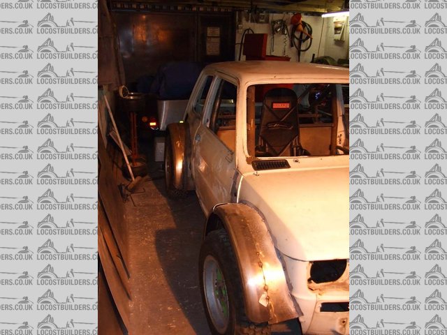

PS the job is taking a long time because with the weight of the rather robust chassis frame, I'm trying to chop out all the unneccesary bits of original bodyshell.
This has been speeded up a lot by the aquisition of the plasma cutter!!!
oadamo
posted on 10/1/08 at 07:23 PM Reply With Quote
looks like its gonna be a beast when done. where did you get the archs rolled.
adam
NS Dev
posted on 10/1/08 at 10:06 PM Reply With Quote
lol the outer bits are steel trailer arches cut in half, welded to rolled 1mm steel sheet that I joggled after rolling to get the join flat (ish!! )
I rolled the flat bits myself in my small set of rolls.
