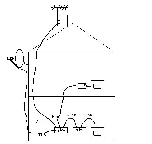

If its any help this is a basic diagram of how my system is connected.

Your diagram is correct. Is the red light on the sky eye link? You do need a 5v continuity running through the cable and some of those cheap plastic connectors wont work.

Well it lights up if I plug it in to the RF2 downstairs but not if I plug it in upstairs (with the RF2 going to the wall), Which would make me think that there is a cable fault. But the TV reception is good If I plug the aerial in downstairs to the wall which makes me think that the cable is actually ok?

If the eye works when plugged in to rf2 and the channel changes then I would plug it in at each step. I.e at the end of the cable that goes to the wall, then the wall socket upstairs and then on the end of the final cable. At least you'll know which bit is going wrong.
Jon
EDIT: Unless that cable you weren't sure about is in actual fact the cable that joins to upstairs. Off to bed now - good luck!
