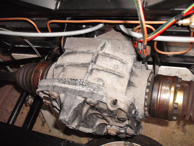

I have attached some pics to show the problem with the lower mounting, the long bolts not long enough and there is a space between the mountings. Is
a spacer (lots of correctly sized washer?) and a longer bolt all thats needed. Any ideas where such a bolt can be obtained?

Measure the disk, if it measures 273mm then it has came from a 2.9 Cosworth which they only made from 91-95 before bringing out the Scorpio.
And yeah, longer bolt and a spacer, any fastener company should have a longer bolt. Or speak to Ben at Luego, if you get really stuck let me know and
I'll get you one up here (my chum owns a fastener co)
