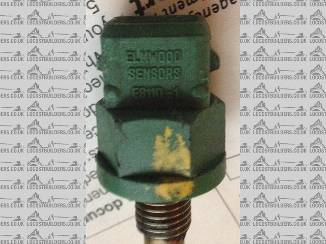

One issue might be if your loom has the combined MAP sensor and IATS sensor.
[Edited on 3/12/14 by britishtrident]
Pretty sure its just a IATS...
