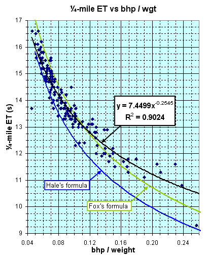

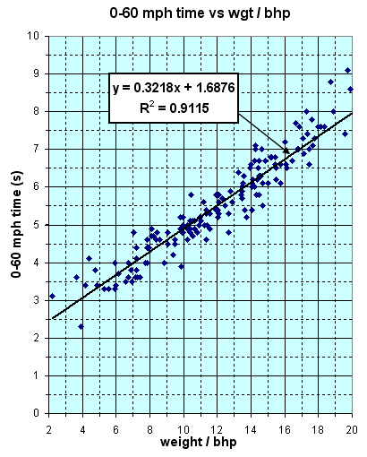

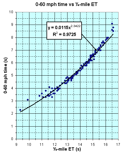

Just had a look at those graphs above which are interesting. There are a couple of factors they don't take into consideration though which may be
a bigger factor for a seven than most, which are aerodynamic drag and outright power.
I suspect most of those figures are taken from fast road / drag cars in the states which maybe have 3-500bhp but weight over a ton. Having 300bhp/ton
in a 1ton car will give different acceleration characteristics to having 300bhp/ton in a half ton car because at higher speeds, particularly with
barn-door aero, outright power has more of an influence on acceleration than power to weight.
I suspect that most sevens will perform slower 1/4 mile times than predicted by their power/weight and/or 0-60 time, because by the time we hit
90-100, the combination of low outright power and brick-like aerodynamic properties are already having a big effect on the rate of acceleration,
whereas if you were in a comparatively slippery road car with say 500bhp that weighed 1.5ton, you'd still be accelerating almost as hard as you
were at 50mph.
Chris
