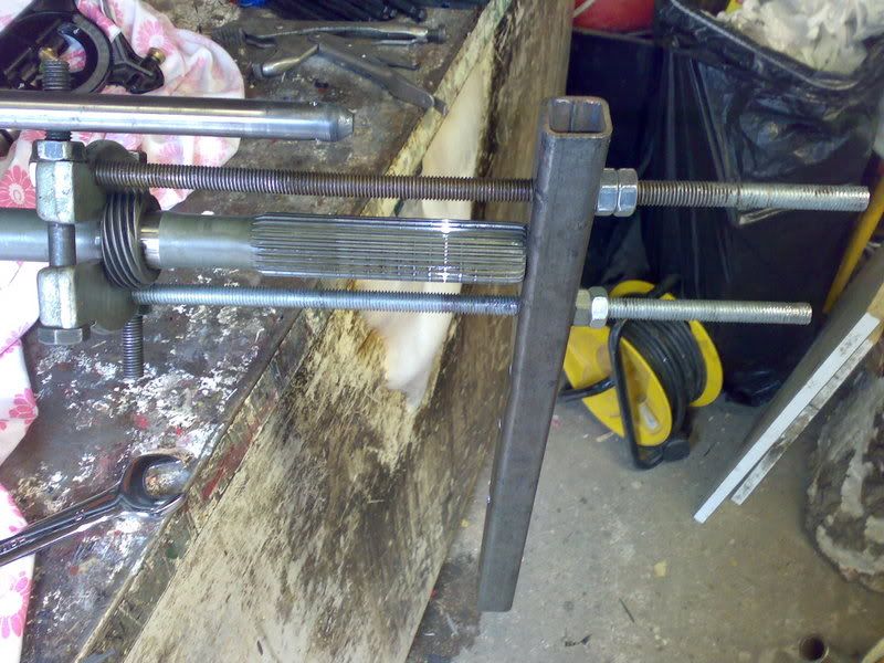

You will need normal spanners etc, 36mm 12 sided socket, good set of circlip pliers, pullers of various types and a load of differnt size drifts.
You need a long puller for some of the bits I used a bearing spliter with two 10mm studs in it and a bit of 20mm box section between them.
One of the pullers also has to be two legged not three.
