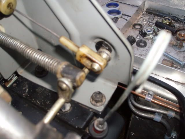

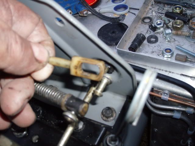

Can you guys have a look at this.
Tell me if there is a clip or something for this. I know, I know, I should check the manual, but I left it in England my last trip

looking good. there should be a rubber mounting that pushes into the clip on the end of the throttle cable

Use a peice of small rubber hose to stop the clip coming off the shaft.

Looking good. There should be a little rectangular rubber with a hole in the centre to go on the pin. It has a slight groove around the outside to
locate the cable end.
