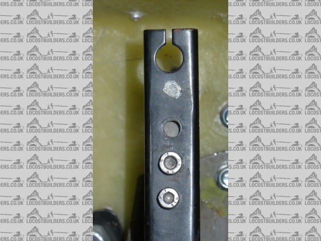

Changed the mechanical fuel pump for a much more modern version. The improvement was worth the effort, but not solved my initial problem.
Checked the full opening of both chokes in the carb by pulling on the cable cam near the carb - both opened nicely
BUT
When I got the wife to sit in the cab and floor the throttle the first choke opened but the second choke barely twitched .
I am optimistic this could be it.
There is no obvious adjustment up at the carb, but the cable attachment to the throttle pedal looks suspect. It attaches the cable at least an inch below what looks to be the normal attachment point. This makes it closer to the pivot point and will give reduced travel to the cable, so I will have to work out how to fix it.
throttle pedal
throttle pedal
[Edited on 28/10/14 by bumpy]
Paul Turner
posted on 28/10/14 at 04:13 PM Reply With Quote
On the 32/36 carb I had back in the early 80's the 2nd choke was operated by vacuum. If there is none it won't work.
