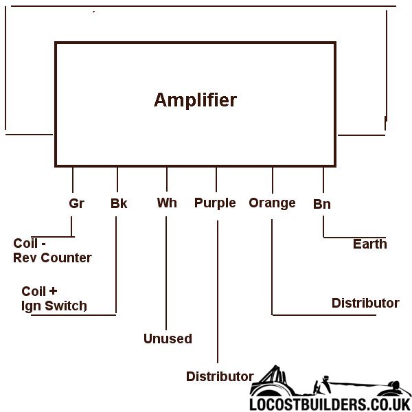

James
posted on 20/4/07 at 09:15 AM Reply With Quote
Hmmmm.
Well this worked for me!
http://www.locostbuilders.co.uk/upload/Working%20Wiring%20Diag.jpg
James
