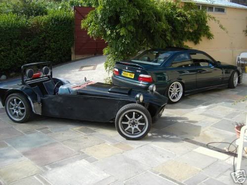

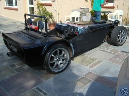

hi gys just got my dutton b plus car delivered last night its got ford escort/cortina running gear 1.6 cross flow.
my problem is that its hard to find gears. i eventually found first but couldn't find second.
anyone have a diaram of where the gears are. supid i know but i'm wondering are the gears in a strange sequece
i assumed it would be 1 3 5
r 2 4 ??
is there even fifh gear in these boxes?
the kit is 30 years old and the gear boxs feels it alright. she fairly tore up the tarmac in first though

it stopped raining and i had nosey. the reverse is to the left and back(lift).
at the lol its 30 years old hahhaha.....you should see the thing ,its in amazingly good nick and pulls like a bleeping train.it was wheel spinning and fishtailing like a mad er...fish? lol!! i'm gonna get it resprayed and retrim the interior then it will look like any other 7 style-ish car
