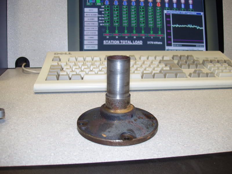

I machined the input shaft trumpety thing down, thus....
and fitted the slve cylinder off a Mondeo (£10 from the scrappy!)
