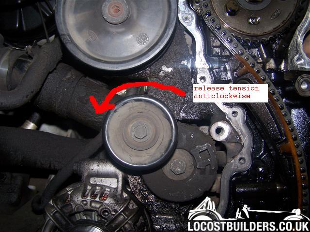

bigrich
posted on 2/11/07 at 05:48 PM Reply With Quote
is this any help, sorry if its stating the obvious
Rich
iiyama
posted on 2/11/07 at 06:00 PM Reply With Quote
Different to what I have. Havent stated that Ive got a 2L petrol!
