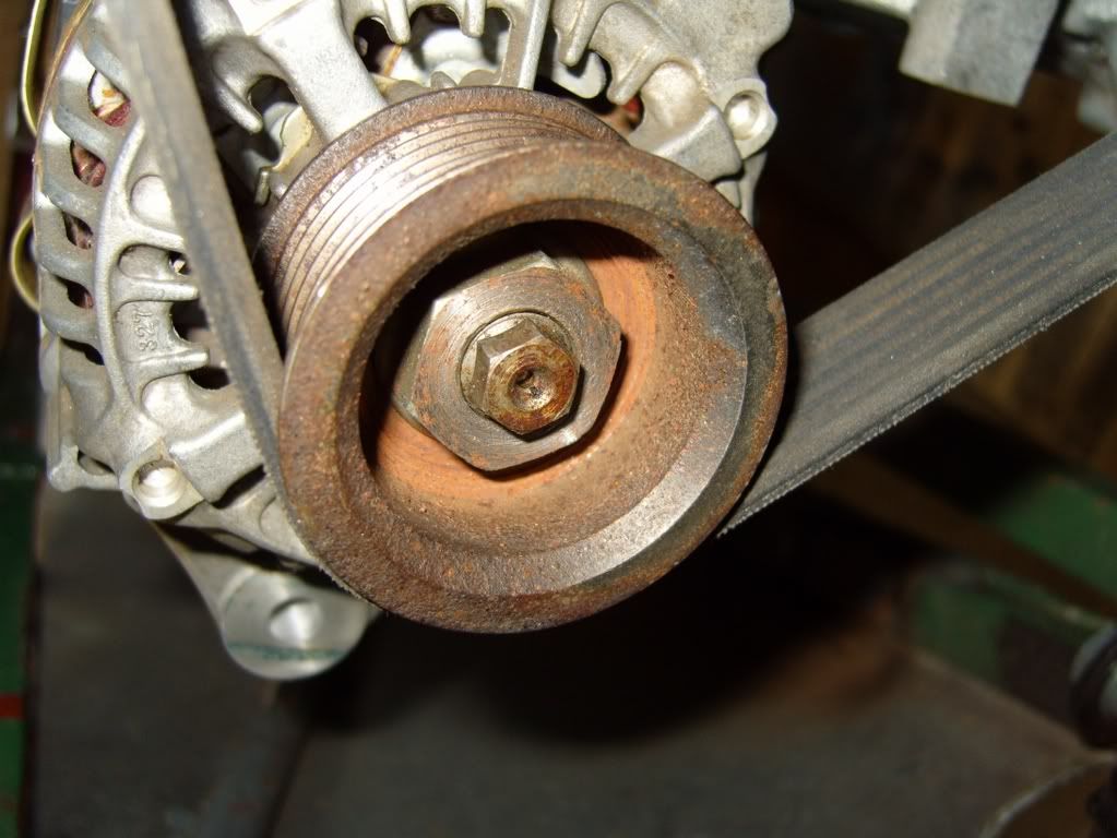

In terms of ribs, it will be to match a zetec-E crank pulley - not sure how many Vs they are..
From what I remember, the shaft on my other mini denso alternator (on a Zetec-S Engine) had a hex end, which allows you to hold the shaft with a 12mm
socket say, and use a big ring spanner to tighen/loosen the main locking nut..
just found a photo..
[Edited on 14-12-07 by takumi]

I cannot belive how stupid I am to have missed that, will check tonight if that bolt is also on the lexus jobbie.
thanx
ps:
I doubt that alloy pulleys are lighter than the normal pressed steel ones, those are very light, must be good for bling though
ps2:
that's a 6rib belt as you can see in the picture will take some measurements tonight aswell
Grtz Thomas
[Edited on 14/12/07 by thomas4age]
