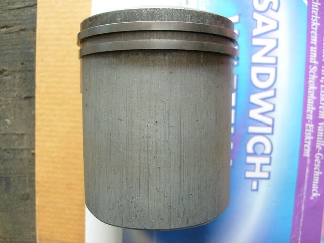

not my engine but got me thinking.
Does it matter if the piston is scored?
my understanding of the inner workings of internal combustion engine is that is that the rings, as well as sealing the cylinder, hold the piston in place so that the piston does not contact the bores. I guess that may not be correct otherwise there would be no need to have the piton below the bottom ring (ooh err!) to the same diameter.
So if the piston is scored, how does it affect the engine?
this is to what I refer: (BSA bantam)
and just for comparison, look how short a modern motorcycle engine piston is!
and this which also shows how little piston there is on the sides.

the piston does touch the walls as it changes direction, look at any used one and you will see the buffed area on the skirt. That one shown is scrap.

That piston looks quite servicable, the bantam isn't a performance two stroke, but it is a piston ported two stroke, so the fit between the piston skirt and bore is important. So as long as there isn't a massive clearence it'll be ok.

It doesn't look very pretty (and I'd be tempted to try and find out how it happened ? running without an air filter) but it's still the rings doing most of the sealing. What does the bore look like- that'll be more of the problem IE if the bore looks as nasty as the edge of the piston you're in trouble...

yip been sucking in plenty of dirt, I see this kind of damage all the time on my r/c 2 stroke model plane engines in the summer due to dust in the air. It can damage any chrome coating on the liner and wreck it. You can see where the grit has been getting dragged against the bore and the piston, they'll be lovely scores on that too.

Don't worry about light scoring like that on a Bantam. They get light scoring like that very quickly as the air filter is a pretty rudimentary affair which just about stops large rocks and not much else.
The liner on a Bantam is an iron jobby and it will have some similar wear but that's not a problem either. These were not exactly high performance motors. The last Bantam was the D14/4. 14 HP and 4 gears. For a 175cc motor it's not exactly over stressed so a few scores and a largish skirt to liner clearance is not a big deal.
Lastly, in terms of the length comparison the Bantam is an old fashioned, undersquare, piston ported two stroke. The other pistons are modern bike 4 stroke pistons so not really the same thing.
ETA Look at the rings. Unless they are very recent they are in good shape which indicates that the bore should not be too shot either.

For a Banty that looks mint!

Ah happy memories! I thought that looked pretty good for a used Bantam piston. I reused far worse and that one does not appear to have suffered any partial seizures (yet). I would have a partial seizure every week during the summer! - I'd pull in the clutch, coast to a halt, roll a cigarette, smoke it, and by then it had cooled down some and I'd ride on. The filter was a joke, hence the scoring.

I've used worse pistons. On a two-stroke they get like this very quickly. The rings look okay. As said airfilters on these in those days were crap. Try to get a k and n to fit. Keep the timing spot on and use good two-stroke oil and it should be fairly reliable. Just be ready to whip the clutch in just in case.
