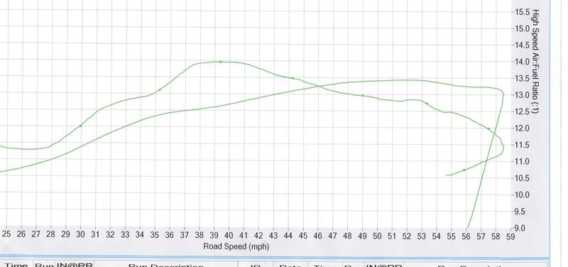

i currently have zx9r carbs on a 1700 x-flow. at a recent rolling road dyno day i managed to get a air/fuel ratio print out which shows the engine running rich at low end & top end & leaner in the mids.
is this going to be easy to sort out or not?? i'm guessing the main jets are going to effect the top end?? they are 140's in there.

here's the graph. it's the line with the dots - showing the peek at 40mph.

I think you will need to change the needles, like used to be done on SUs, they had loads of different tapers to sort this, I assume mikuni etc. make a range but suspect it will be a long and expensive job to sort

is the typical bike carb graph....
It's a good place to start looking for answers. Bear in mind carbs are always going to be a compromise...

it was a full throttle 3rd gear power run - yes the gearing is low i'm estimating the graph shows from 2,250 to about 6,000 rpm so i'm guessing a smaller main jet??

I would say,
Adjust air screw / change jet to lean it off a little.
LIFT the needle ie lower the circlip to its bottom or next from bottom position.
Top end looks about right for power but you could try a leaner main to see what happens.
The jets are available from most decent bike shops as mikuni jets will fit most of the carbs in the range.
Needles are quite adjustable but if you need to change them buy the dyno-jet kit as the most cost effective option.

i don;t know a lot about the carbs tbh. i don't think the needles are adjustable with the circlips - will have to take a look though.
how much is the dynojet kits?
this is where i'm torn between getting these set up properly or swapping to 45's which a lot of tuners can easily deal with - i'm estimateing a 45's swap brand new all in to cost best part of a grand though

If the needles dont have circlip grooves,you can raise them with little washers.
I got some in a model aeroplane shop.
Like Nick says,I'd try a smaller main.
Bike carbs are usually set up in the order-
Main jet
needle
idle jet/mixture
ie-set up the main jet first as any changes you make to that will also affect needle jetting as well.

if it's running 140 minas now [i'm 99% sure it's 140's] what do you reckon to drop down to?? i know i can swap them ok.

It's impossible to say,could be 135,130,etc.You really need to set it up properly or use a lambda guage if you can get hold of one.
