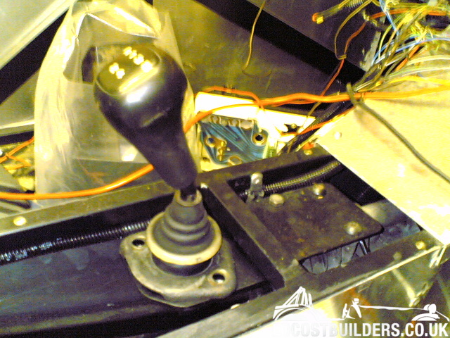

type 9 gear lever
i'm after a very short, straight gear lever for a type 9.
I want the gear knob to be where the purple circle is, and want to take out the bend next to the red arrow.
if i heat it to bend it, or if i cut it and weld some new tube on i'll damage the rubber bellows and springs with the heat.
and where the circle is, i think the shaft opens out to about 1" diameter and then a rubber bush, so i don't think my gear knob will fit
over that bit anyway.
any ideas on taking it apart? how easy is it? how easy does it go back together?
anyone got one going spare already made how i want it??
i'm looking for something more like this
the threaded bit on the end would be a bonus
[Edited on 24/3/09 by blakep82]

Cut the bell (where you have circled) and thew top bit falls off (with a bit of persuading).
This leaves the bush sitting pressed onto the lower bit that goes into the gearbox. Cut remove the rubber along the length to expose the sleeve and
file or cut carefully along the length of the sleeve to release it off the gearstick.
This will leave a stub exposed which is the right diameter for cutting a thread down for you to screw the gear knob onto. Before you cut the threads
remove the circlip and rubber covered spring and disassemble gear stick from mounting. Straighten gear stick as required, then reassemble and cut
threads. Job done, takes about 30 minutes all told and is a LOT cheaper than buying one.
I left mine with a bend in it, but this is what it finished as
Hope this helps.

when you say 'cut the bell', do you mean round it? on down the length of it?
also, been out there this afternoon, undone the 3 bolts (theres no extention on mine) but the lever won't budge when i try to pull it out.
don't know what i've done to it?

From the bottom of the bell up to where it starts to curve, I used an angle grinder for this and cut on opposite sides, be aware this is liable to
start the rubber in the insulator bush burning. this bush is just like a metalastic suspension bush, outer metal sleeve (this takes the upper
gearstick which is pressed over then peened at the lower/open end of the bell. Hence it needs to be cut/ground off ), rubber isolator, then inner
metal sleeve (which is a press fit on the lower gearstick.
Have you got the gear selector in neutral?, other than that it could just be that not having been out for a long while it could just be a bit
reluctant.
[Edited on 24/3/09 by jollygreengiant]
