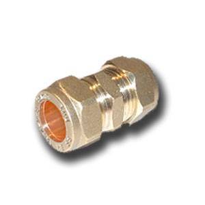

I bought a compression fit 10mm inline connector from Whickss..
Drilled an undersized hole in the alloy bottle and simply screwed one side of the connector into the bottle with some silicone to seal/hold it
inplace..
Seems to have worked well with no nut on the other side!
The slightly neater solution as done by someone on here (sorry cant remeber your username), was to get some threaded connectors for compressed air...
threaded one end and smooth the other.... that and a carefully fiddled nut inside the tank would work too!
