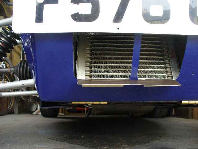

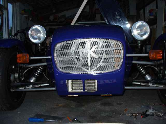

MautoK
| posted on 27/7/09 at 06:37 PM |
Just in front of the rack:
  Cooler
Air inlet:
  Air inlet
Close up:
  Cooler inlet
The cooler is for ATF - the autobox was getting a bit, ahem, warm (blowing oil out ).
I procured the cooler + pipes for £20 from a gent on LCB and originally thought I'd mount it alongside the bellhousing with some fabricated
ducting to get air in and out.
So I redesigned the pipework to locate the cooler up front and ended up spending another £75 on pipe, tube and fittings. As said above, not cheap.
They tried to sell me some hose at around £40 /metre.
I ended up making most of the 4 foot runs with steel pipe.
Anyway, it seems to have been successful as I did 50 miles a few days ago and it behaved fine.
John.
